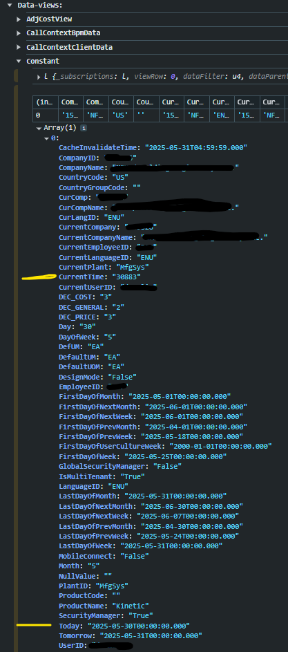

If you open the debugger you can see what is in your dataview, like actionResult.
But there is also a Constant dataview you can utilize if it is not a previously stored value from a query, etc.
If you’re looking to just set today’s date, you can use Constant.Today
If you’re looking for a time stamp… you can also use Constant.CurrentTime… but it will return an integer you may have to convert to a time stamp.
Thank you!
I think Constant.Today is what I’m looking for.
