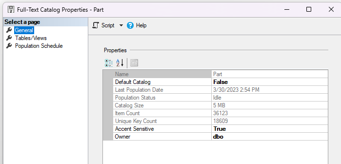

My suspicion is that a problem has developed in my Production system index since the January data was backed up. The properties of the Full-Text Catalog indicate that it is being populated regularly.
I have also used SQL Server Management Studio to rebuild this catalog, but that had no impact.
