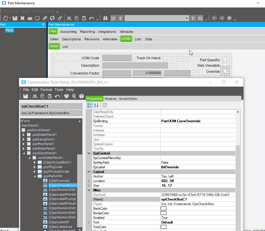

In Part Entry there is a checkbox that is normally not on the form, do a UI customization and when you check this it will allow you to change the conversion. It will uncheck itself after you save. You may want to put some security on this field. The below screen shot is from E10 but this field is available in E9.

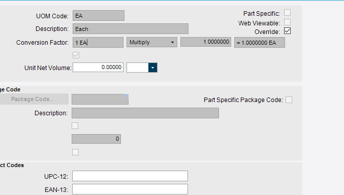

In my environment I tried this and it didn’t end up working. Here’s a pic:
From what I understand, you check the Override (I had to add this field manually) checkbox and then you can change the UOM conversion data. If that’s how it’s supposed to work, then it doesn’t…

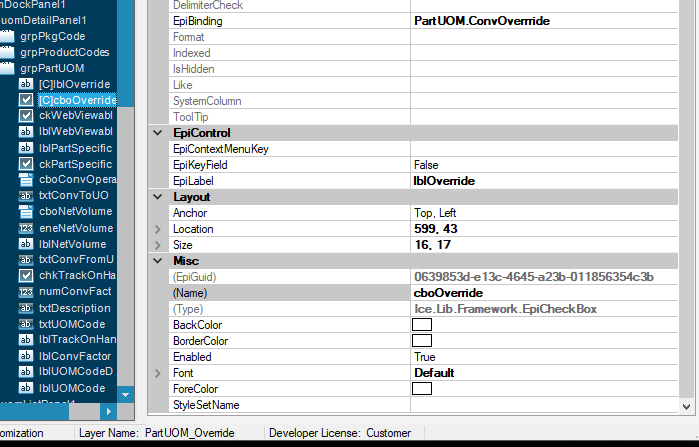

Another pic:

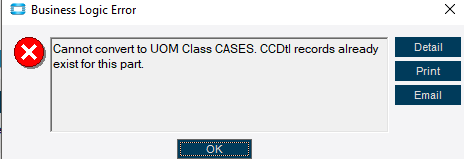

Edit: I understand that in 10.1 we have Part UOM Conversion Maintenance, but even that doesn’t work:

If anyone is wondering about the Override Checkbox, you can display it by doing a Personalization on the Grid and according to Epicor it will only work if you have no Demand out there…
