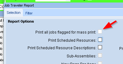

  • In reading some other posts, there is a checkbox on the job traveler that is titled “print all jobs flagged for mass print”. We have hidden this checkbox so is not available for users.

Hi Mindi,
I have an idea ~ I once had a checkbox hidden in sales order entry and a user was getting it checked by tabbing through and clicking spacebar. I needed to remove tab stop on the hidden field.
When I open Job traveler report and immediately click spacebar, it checks that “print all jobs flagged for mass print”… any chance user is opening it, hidden field still has tab stop and then they are pressing spacebar?
Nancy
@Nancy_Hoyt - I just did a test, and in 10.2.300, setting the checkbox’s Visible property to false, makes the control inaccessible. The next item in the tab order (“Print Sched Resources”) has focus upon the form loading.
@MDiekhuis - Set the checkbox’s Enabled property to false, and make visible set as true
You’ll be able to see that value of it, but not be able to change it.

When customizing the form, that checkbox is bound to
  • ReportParam.PrntAllMassPrnt
Yet that’s not a field in the dataset of the report RDL.
Might be able to add it, and then include it in the header. To see if that is actually the cause.
Hi Nancy! After reading these comments I had an idea and… aha! I went to MES and tried to print a job traveler from there and lo and behold the checkbox is NOT hidden that mass prints all the jobs. I also tried the space bar for fun and it checks it. So, that is our answer that we successfully hid the “select all jobs for mass print” from production but not MES. Thanks for your help! As a side note I did try the space bar in production (the one where it isn’t visible) and it does not check all the jobs. So that’s good.
