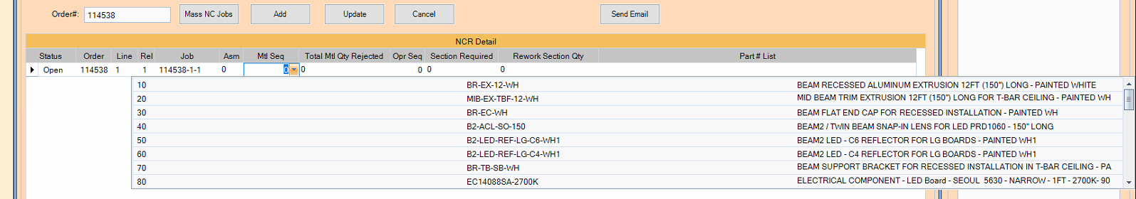

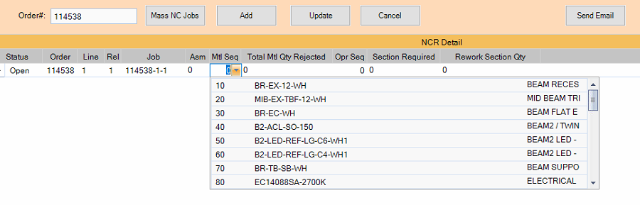

I tried to set the epi combo property for the AutoWidthOption to TextWidth but it doesn’t affect the columns and it doesn’t show the third column .Is there a way to expand and adjust the text? I call this method to retrieve the materials from a job
