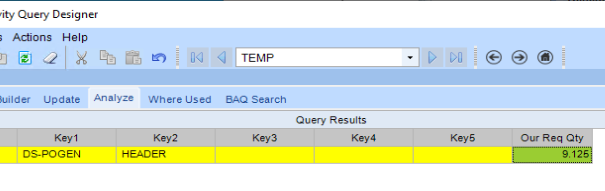

I’m testing changing a decimal column from two places to three:
Then after a regen, it looks okay here in this updatable BAQ:
But after the update the number is rounded to two places:
Did I miss a step?

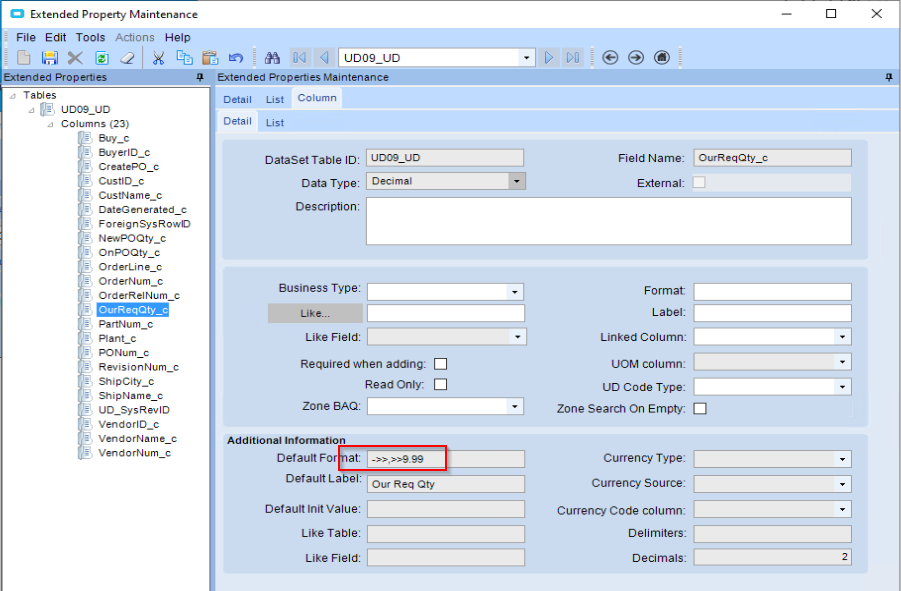

Have you checked to see if you can make changes to it through Extended Properties?
with what @jkane said in mind, can you use the extended properties on a UD table?
We had to change the number of digits shown in the “next order number” field as it defaults to being 6 digits wide, and our next number needed to be 7 digits.
That’s what it looks like to me–I can enter three digits to the right of the decimal, but after I save it the number has been rounded to two places.
I’m testing the update in the BAQ, and just to make sure, I deleted the table and readded after the regen.

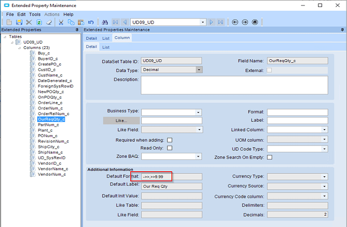

It might not be possible to change. Here is what the Extended Properties shows. Only the default format shows, and it’s read only.

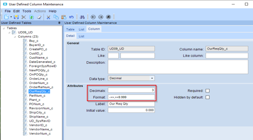

Kind of makes sense that it’s read only, as you’re able to set it in UD Table Maintenance. One would think that it should match what is shown in UD Maint.
Well, there’s Decimals way down in the bottom right, but still greyed out.

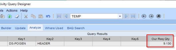

So back to the original point… You have a UBAQ, that when you get records it shows 3 decimal places. If you enter a value like 9.125 and update, the BAQ designer shows “9.130” after the update. Correct?
If you fetch the records again, it shows “9.130”?

Whatever it is that’s doing the rounding, the three-decimal place number goes in and the two-decimal place number comes out.

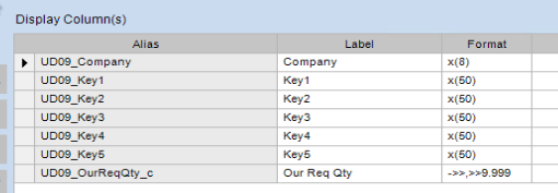

@jdtrent the controls in screens and BAQs will have absorbed the original format. Look at your BAQ’s number format
Yes, good idea. I deleted the table and readded after the regen to make sure it got the right format:

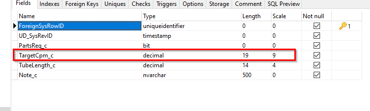

Just re-read what you sent in the trace. I would say type in SQL did not full update. Should be easily fixed manually but you would need SQL access to do it. My guess it’s still defined in SQL as DECIMAL(20,2) instead of DECIMAL(20,3).
Hindsight create everything at 9 places and visually format in the system.

Just tested it our testing system. Updated decimal value and formats updated and database type updated as well. Scale was 4 it’s 9 now.
