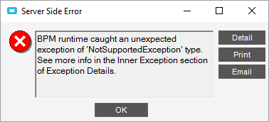

When I run the code, I get this error:
Server Side Exception
BPM runtime caught an unexpected exception of 'NotSupportedException' type.
See more info in the Inner Exception section of Exception Details.
Error Detail
Description:  BPM runtime caught an unexpected exception of 'NotSupportedException' type.
