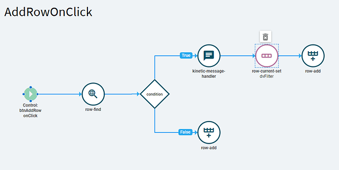

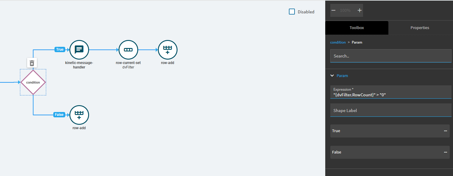

Here is my event
I am counting the number of rows in the row-find and storing it in a temporary dataview field dvFilter.RowCount. I have confirmed that this value gets stored each time I execute the button click. In the condition i check to see if the value of dvFilter.RowCount is greater than 0. This is working
Next when I see that dvFilter.RowCount is greater than 0 I want to increment that stored value and assign it to the value of SplitID in a different data view, dvUpdate.SplitID.

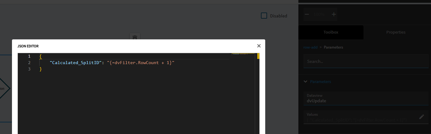

All attempts to increment to increment this value and display in this new row have resulted in something that resembles this
but should be the number 2 in this case.
Here is the JSON value statement in the row-add
I have been working on this for a day now with no success. Any Suggestions?
Try putting the curly brackets around only your dataview.column:
"Calculated_SplitID": "{dvFilter.RowCount} +1"
This part, {dvFilter.RowCount}, should return your current row count.
also I would try
{dvFilter.RowCount} > 0
Mine actually works for the condition check.
Got closer with your suggestion. But still not a number

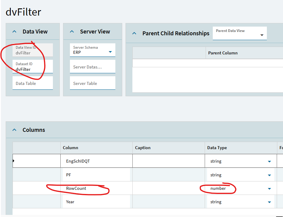

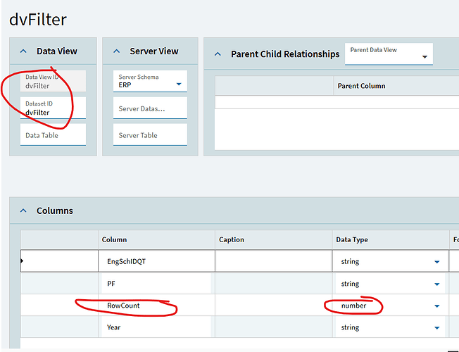

You said dvFilter was a temporary dataview right? I know with transview it seems like any field you define on the fly gets stored as a string. Maybe you can define RowCount in the dataview and make it an Int so you can do math on it?
Are you sure…
Yup
Did that from the start and confirmed that there was a value in there from the get go before trying to increment it.

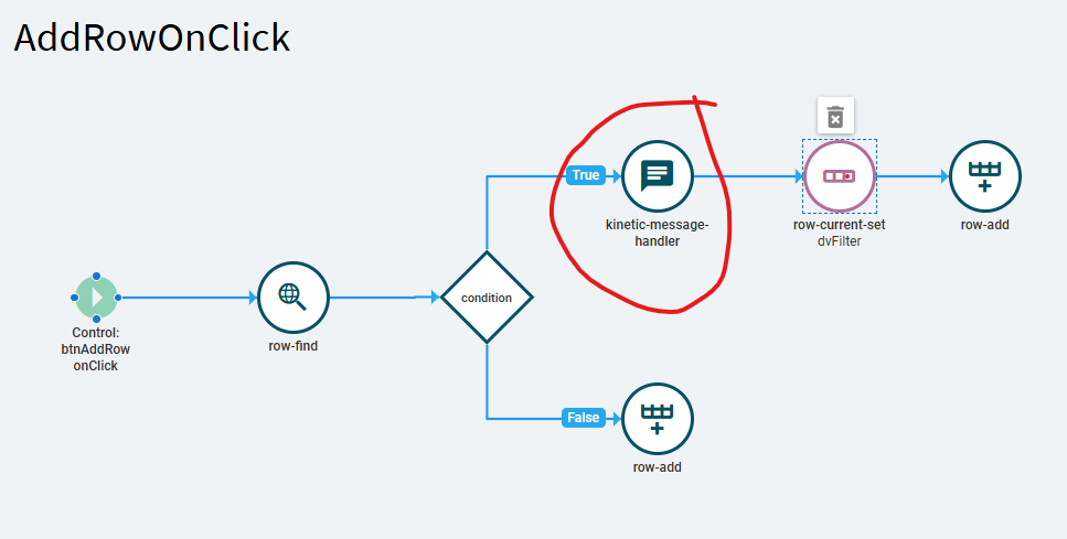

Show where you set it.

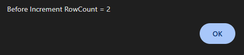

This is the KMH that displays the alert
Tested yours and it works as well.

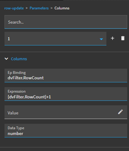

Maybe just ditch the double quotes altogether? I tried doing a test with the row-update widget and just putting {dataview.column}+1 in the expression field worked.
If removing the quotes doesn’t work you could add a row then update it with row-update.
For some reason the + sign is being interpreted as a string not an operator.
“Calculated_SplitID”: “{dvFilter.RowCount} + 1”
Change this:
Into this:
“Calculated_SplitID”: {dvFilter.RowCount} + 1
Javascript?
“Calculated_SplitID”: {dvFilter.RowCount} + parseInt(1, 10)
SWAG here.
@cory.davis
I added this back into the Row Update and then the add row with
“Calculated_SplitID” : “{dvFilter.RowCount }”
Worked… Thanks for your help!!!
