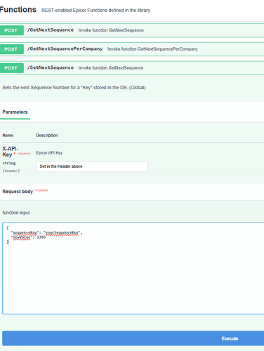

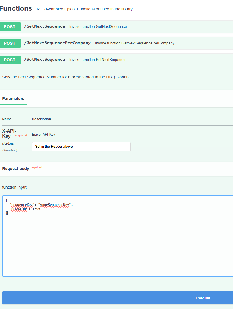

Thanks @josecgomez ! I am new to using Functions but was able to get GetNextSequence working between the link you shared and a CodaBears YouTube video. However, the GetNextSequence starts at 1 where I need to start with the UD100.Key1 value of the last record (e.g. 00000001394). I have been playing with the SetNextSequence but not having any luck. Any suggestions?
My function library has the SetNextSequence in there.
You can set it to the next one, and if you need the leading zeros, add that for your key.

Ok, all you need to do is go grab my function library, and use the resthelp, or swagger to run the function SetNextSequence to the value you want next, just once.
Every time you call GetNextSequence for that key, it will bring int back and you just need to add your leading zeros like before.
Thank You! This was a learning experience as I have never used resthelp or swagger but was able to find some documentation and figured it out. I had to add an API Key and Access Scope that included the SetNextSequence function before I could run the function in resthelp.
