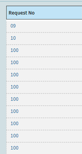

@klincecum - the custom code you provided worked until you get to 10 and then it keeps assigning the number 10 to each row. I am guessing because the Key1 is a string field and the code is converting the number to a .ToString() but am not sure what to do to solve this. The column in the grid also sorts the 10 wrong since the field is string. Any suggestions?

@klincecum your latest works until I go over 100 and then I have the same issue.
I was able to get it to work by using int lastRecord_ID = 100000;
Unless you have another suggestion?

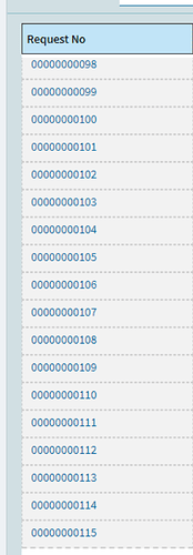

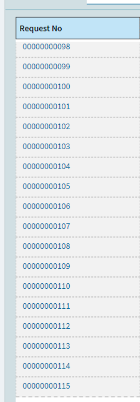

THANK YOU!!! that works. I left it at 10 leading zeros to be safe. This is basically a sequential Request No that will be printed on a form and the Key1 field is the link from the Kinetic Landing Page to the Detail page. Thank goodness for DMT as I utilized it to Add and Delete records for the UD100 table in bulk to test this.
