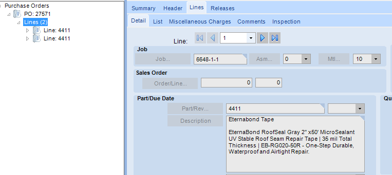

Is there a way to put individual lines on hold for a PO vs putting the entire PO on hold? We have PO’s that have more than 1 job on the PO but they are part of the same overall project.
For instance, we have job 1234-a and we have job 1234-b. Both are from the same client and both are for products from the same vendor. These items are custom (made to order) products. But 1 of the products has a small change and purchasing has to wait on Engineering. And the other product is fine and the vendor can ship it to us while we are waiting.
With these issues/parameters, is it possible to place a single PO line on hold instead of the entire PO?

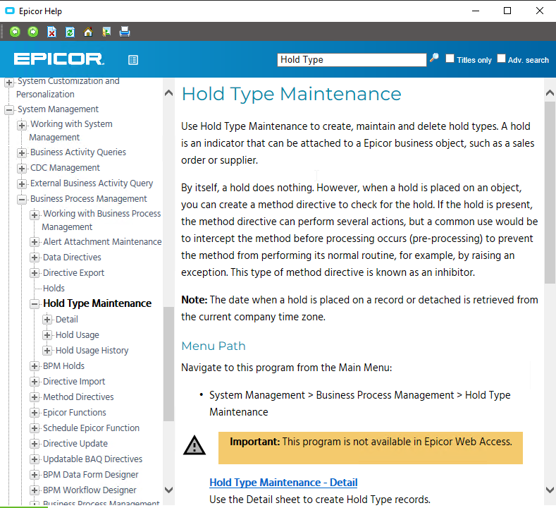

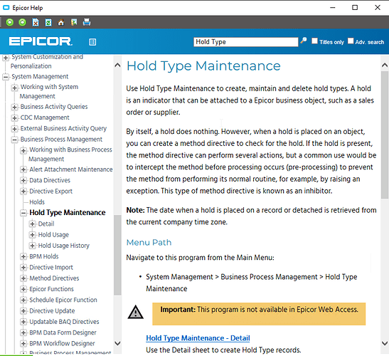

Would creating a new Hold type for PO Detail work for you?
