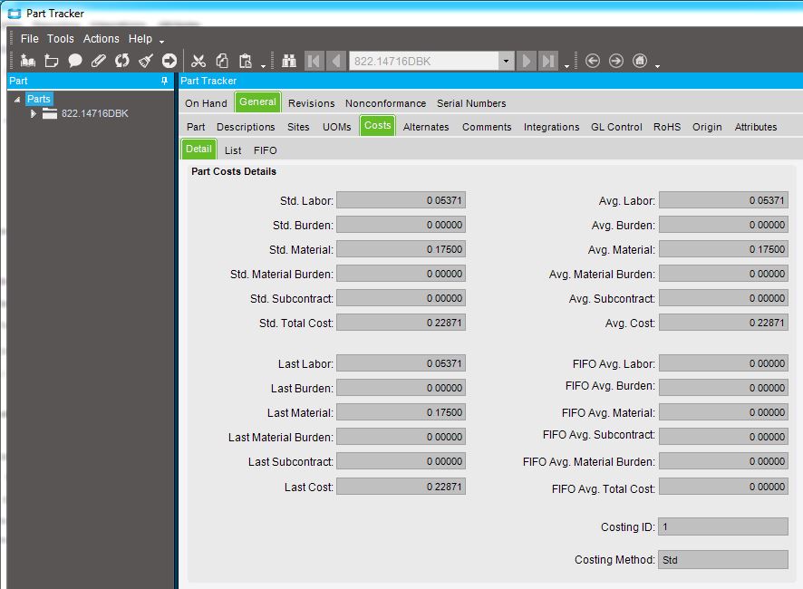

Before I run down everything I wanted to post these pics to make sure I am understanding correctly.
The 1st pic, at the STD Material is .175 and the 2nd pic has it at .17251. The top one is correct, but the 2nd pic is off. Should be an Std material of .21667
The parent parts are set up as Avg, and these are Std. Scrap is set to zero.

Your part is standard costing. I see it at the bottom of the Part Tracker snips you posted. I would bet that this part has not been cost rolled. You can do a cost roll for the part without posting it. Do that and see; it should give you what the cost should be. It should match the BOM cost report. Once you have done a cost roll and post it, then it would equal the BOM cost report. If the costs are not right in the cost roll (before you post it), you need to look at the method of manufacture to find what needs to be changed.

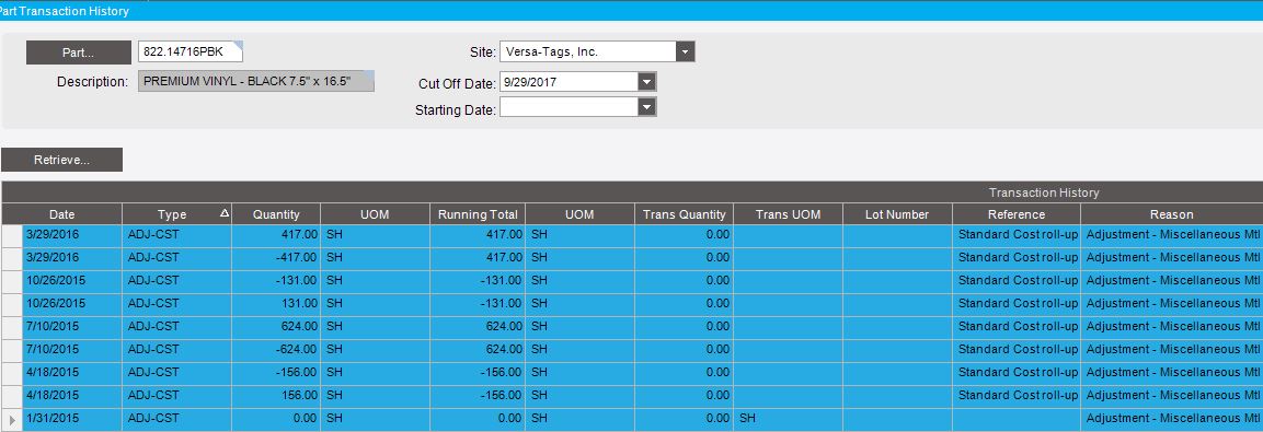

I suspect the part was not cost rolled before. If you look at part transaction history and look at “ADJ-CST” transaction with Reference " Standard Cost roll-up", i would suspect there would be none. The cost could’ve intially been loaded via Cost Adjustment or DMT mass upload. (just a guess) rather than Cost Roll via Costing Workbench.
The last time a cost roll up was done was 3/29/2016. How often should this be done? And yes, we migrated back in 2015, before I was around, and everything was imported over.
