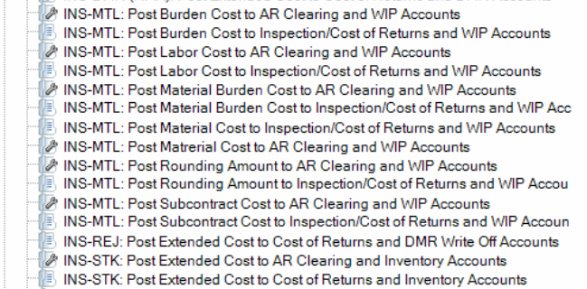

I went into to this today because our accountant wanted it fixed and I needed to get PS involved if I could not do it. It was actually pretty straightforward. In 11.1.200 all of the non AR Clearing rules are also in the COSAndWIP GL Transaction Type in case use AR Clearing is not checked so you can copy those rules.
I did these with the edited indicator

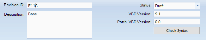

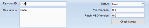

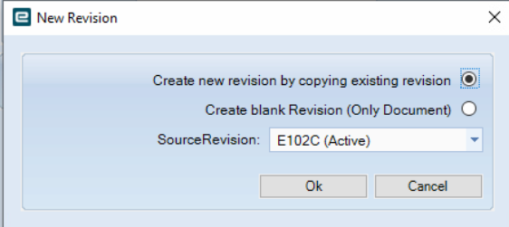

EDIT: To start you need to make a new revision
It will copy from the active revision
The new revision will be a draft.

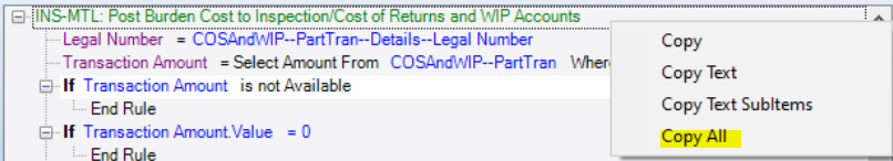

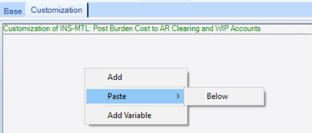

Go into the not AR clearing rule version and right click copy all
In empty customization tab in the matching AR clearing rule do a right click - paste below

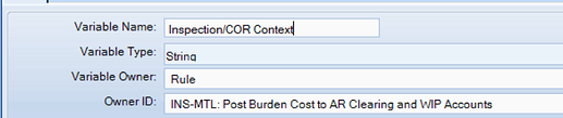

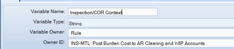

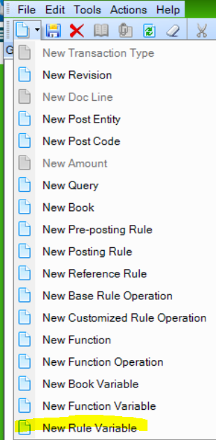

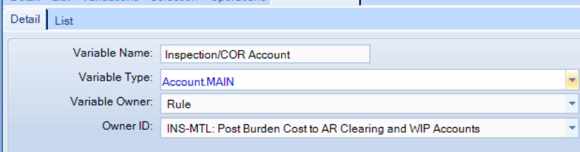

Then you need to make two Rule variables
Repeat this for all the rules you need.

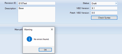

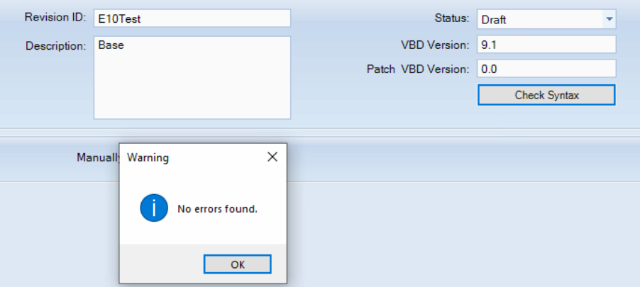

Check Syntax

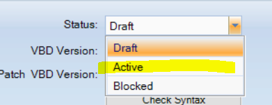

ONCE A RULE IS ACTIVE YOU CAN NOT EDIT IT ANY LONGER. You can make another draft from it and continue, but be sure you are finished.
Promote it to Active

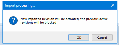

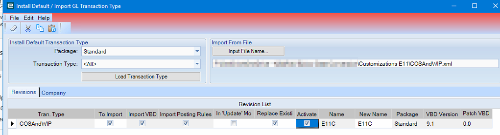

I did this in my dev system and then exported the COSAndWIP to import into test for review and assuming it passes muster then it will get imported into live.
