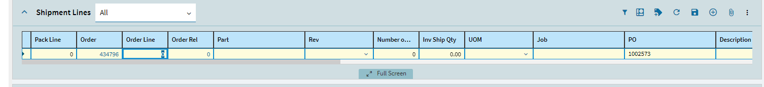

I am trying to scan a DW-39 code in Kinetic Customer shipment entry lines grid. The problem is, the barcode has 3 values separated by tab.
Now when this code is scanned in lines grid, as soon as “order” column is provided as input, the system processes with the blue bar on top and remaining input is not taken.
Is there a way to provide a delay between tabs?

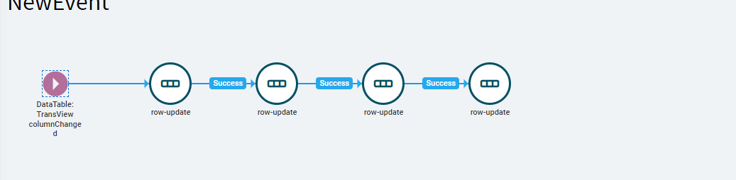

Created following fields for scanning
then did the following event for each field
