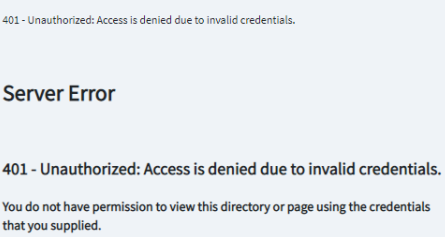

but get this:
How would I stuff the key here?

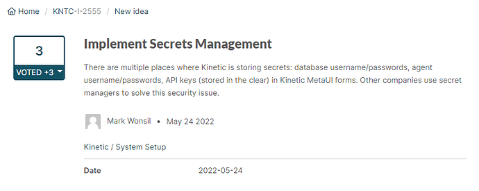

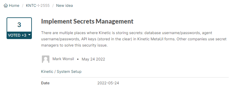

Epicor Idea 2555
MS Keyvaultttttttttttt
Key Vault is one but others could be used. Epicor could also use the Sodium open source project to develop their own too.

By this I meant, build secrets management into Epicor Identity for example. But there are others like HashiCorp Vault. Epicor has to think about the on-prem or private cloud folks too, who may be running in AWS, GCP, or a private Azure tenant.

I asked while in the Extended Education class for Application Studio and all of the Epicor employees did not have an answer for this. That’s why I submitted the Epicor Idea during Insights last week and let @amelton know too. Maybe @bconner or @edge have some thoughts on this?

Actually, Brian reminded me that if you have Session in the home page (and you should have), then Api Key is not required. You need to send Session header and it is sent automatically in Homepage.
You should try.
