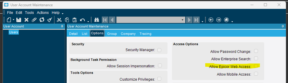

Oh and to use those links, this has to be set for the user in User Account Maintenance, otherwise when they click on the hyperlink it will do nothing.
