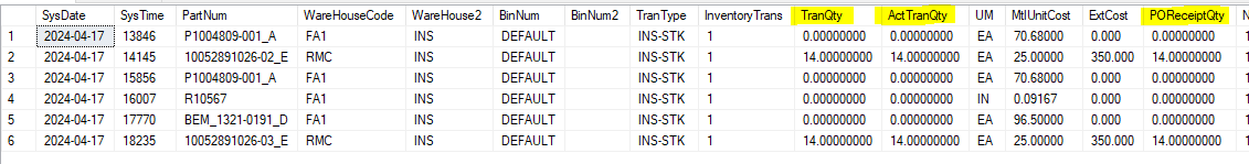

If anyone can help, I would love some suggestions. I am trying to complete a PO Receipt inspection using the InspectReceipt method. Almost everything works as expected, with the exception on the part transaction qty to stock. The method is creating the PartTran record, but the TranQty and POReceiptQty is zero every time. I get no errors and the InspectionPending clears from the receipt.

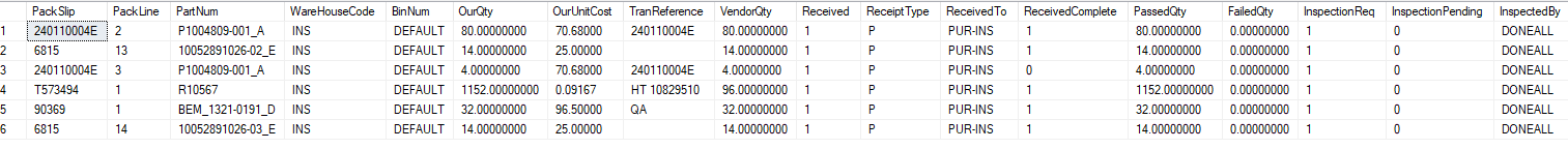

Thanks again for the suggestions Dragos. I reorganized the code to do as you suggested, but it still has the same result. However… In the process of testing your suggestions, I was looking at the data again, and found the solution.
I use this code to write the values of the dataset to a CSV file before and after I make all the updates to the dataset…
			string filePath = "c:\\temp\\dsInsp_before.csv";
			using (StreamWriter writer = new StreamWriter(filePath))
			    string headerRow = string.Join(",", GetColumnNames(dsInsp.Tables[3].Columns));
			    writer.WriteLine(headerRow);
			    foreach (DataRow row in dsInsp.Tables[3].Rows)
			        string[] sanitizedRowItems = Array.ConvertAll(row.ItemArray, item => Regex.Replace(item.ToString(), ",", ""));
			        string dataRow = string.Join(",", sanitizedRowItems);
			        writer.WriteLine(dataRow);
When I was comparing the before and after dataset, I noticed a field named “DimPassedQty” that still had a value of zero after I performed the OnChangePassedQty method call. So I ran another test where I manually set the value of that field, and it worked! I now have a TranQty in the INS-STK part transaction.
