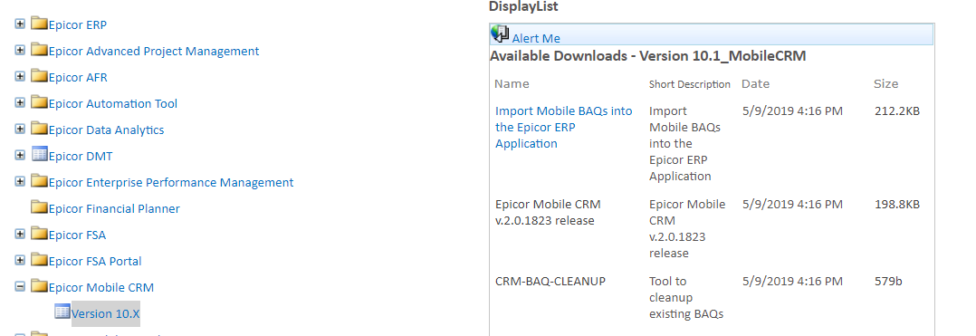

what version of Epicor? Prior to 10.2.x you need to install another file to get those scripts in the DB Scripts pane…
Did you download the scripts?
Okay,
After installing the CRM_Cleanup_3.2.200.0.cab file through the solution manager (I just picked the solution manager from one of our companies) I now show the nodes in the Administration

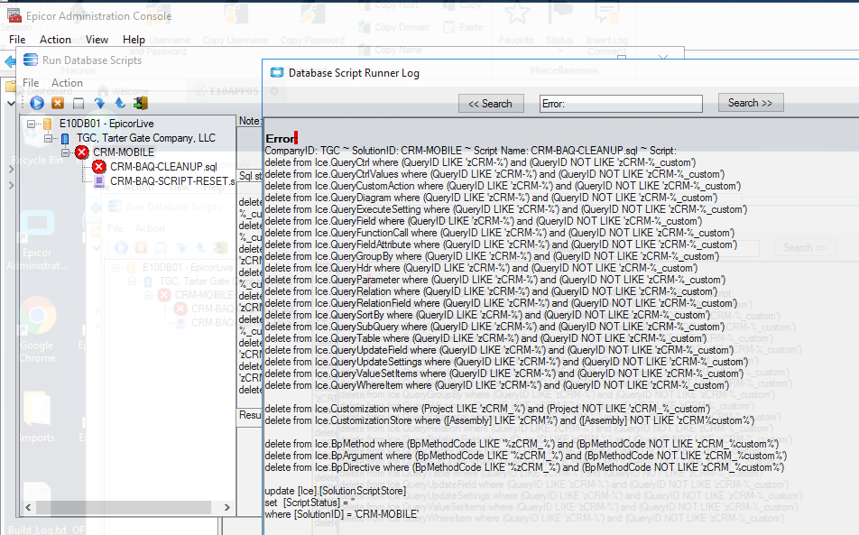

We are on version 10.2.400 patch 10. Never installed cement Mobil but having trouble with the scripts as they error out and do not remove the baqs
What is the error? I only did this once locally and it worked but since I don’t usually use the Admin Console I’m not sure exactly what it does.
If you have direct access to the database you should be able to run the scripts directly, though it would be better to try first in a test environment if you have one.
I will run the scripts in a our test from sql and see how it does that way. Thanks.

So running the scripts from the SQL server got me a little further as I was able to remove the existing and import the new.

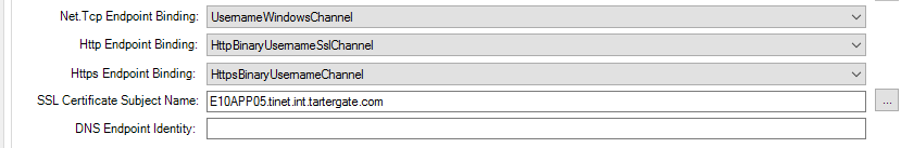

We are on 10.2.400 patch 10. If I read correctly REST services are installed by default in this version. Looking in the app server configuration I had a setting for the net.tcp://
but not an http:// or https:// endpoint binding so I added them and guessed at the type as there were quite a few choices. Below is a pic of what I selected. Should I have used something different?
