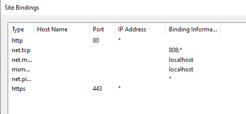

Default bindings:
Rebooted the server. Same.

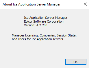

In the EAC, there is this extra text:
Where would one get an updated EAC? Don’t see any in EpicWeb… :thinking:
@Mark_Wonsil It is under the deployment folder.

Thanks Greg! Updated the EAC.
