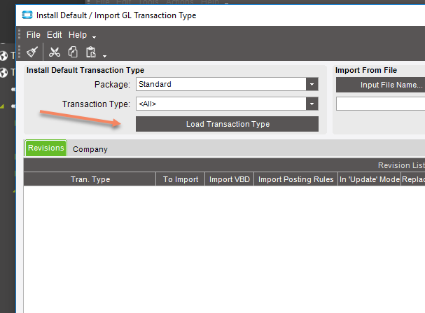

Trying to get our GL transaction types installed. In our environment.clicking on the Load Transaction Type button does nothing.
It appears to work ok against the Demo database, has anyone seen this before?

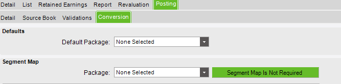

I’m not sure if the Book->Posting->Conversions settings have any impact on it working. This is really the only difference I see between our environment and demo.

I did a SQL profiler trace and discovered when you click the button it does a select on the epr.postingrulepackage table. This table is empty so that’s probably why nothing shows up. I am not sure how it is populated because out test system, which we have been using during our implementation does have Posting rules installed, but the erp.postingrulepackage table is also empty.

So far it looks like Conversion 830 was not run, not sure how it was not, but the logs are indicating this. This was preventing the list of posting rules in showing up. We still got some of them being blocked, but once we deleted and selected them individually and ONLY checked the check boxes in the grid not the ones to the bottom left of the form they imported. Go figure.
