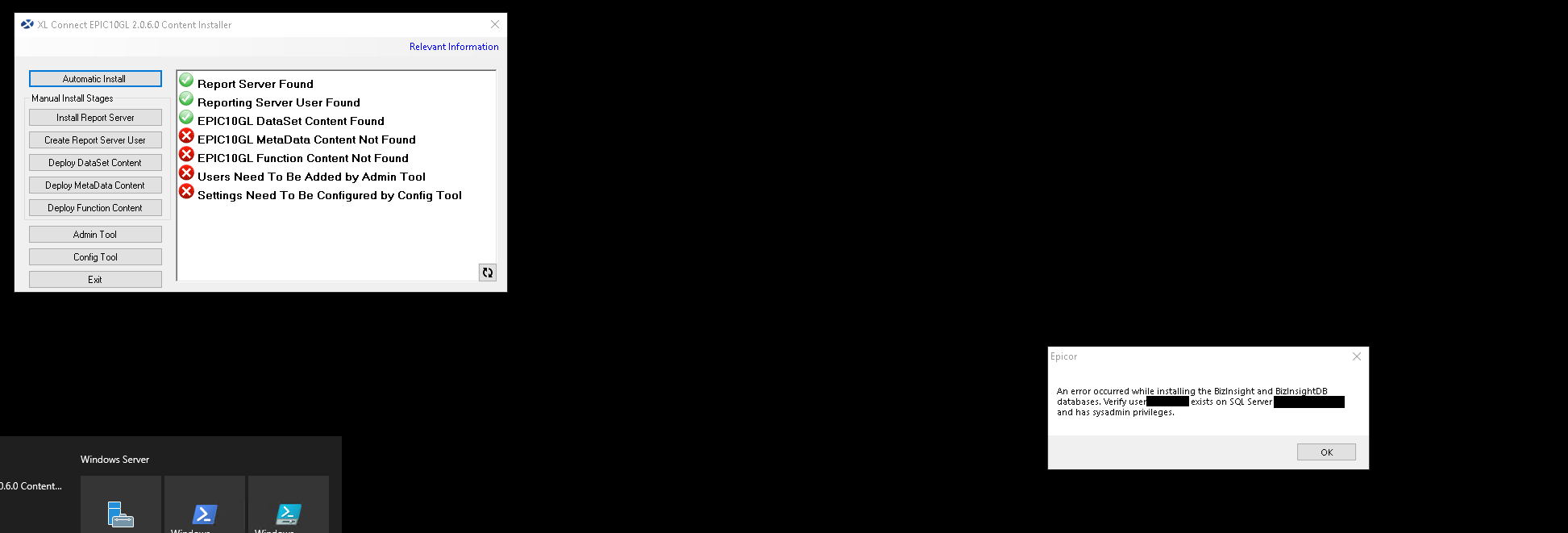

Hi,
I’m attempting to set up a new installation of XL Connect 6 in a testing environment - however, I’m running into a permissions error when attempting to deploy Meta Data Content.
Connection was validated on all previous steps.
I suspect this is due to incompatibility between XL Connect 6 (version 2.0.6.0) and the environment. Relevant program versions are:
MS Server 2022
SQL Server 2022
Epicor 2024.1.8
None of these versions are listed as compatible on the installation document, probably because they didn’t exist at the time of writing.
Does anyone have any experience running XL Connect 6 on an environment this updated?

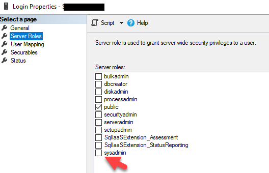

Have you verified that the SQL login does indeed have SysAdmin privileges?
It’s referencing a windows account, but that windows account is set up in the SQL server and does have sysadmin privileges.
