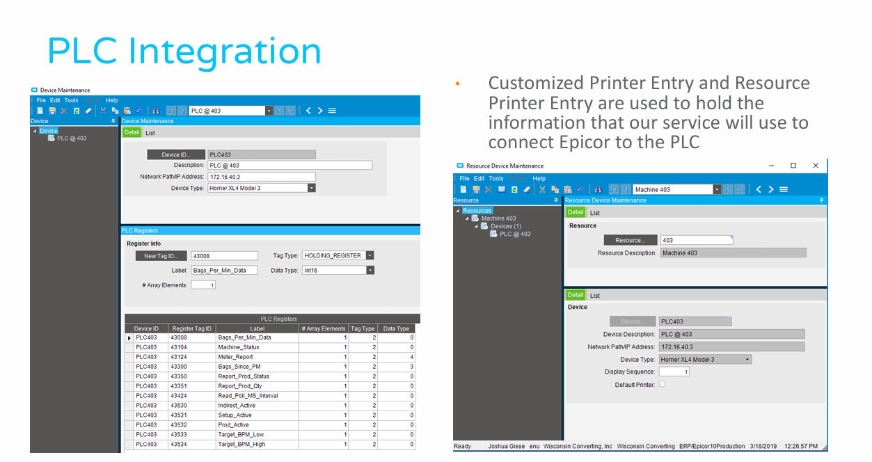

There are a couple of companies here that have done some serious home-grown cool-ness by tying it all together. A most impressive setup can be found with @jgiese.wci !!

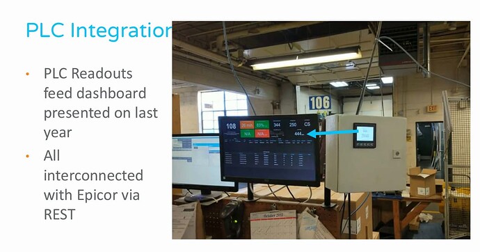

Our recipe of components. All the vendors we have selected have great support (Horner and Inductive) Machine Uptime Tracking - #3 by jgiese.wci

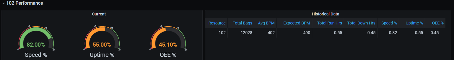

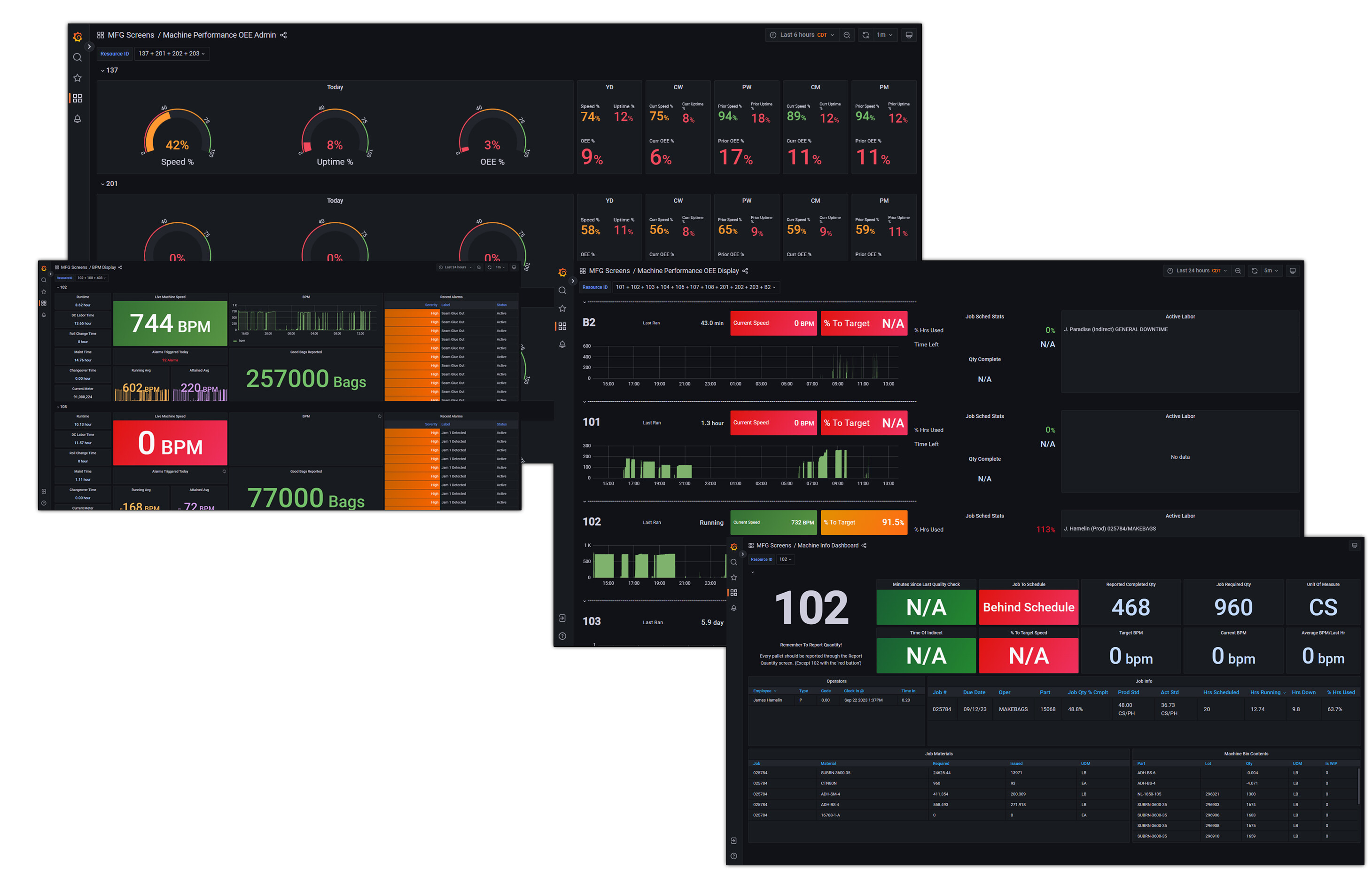

We are currently working on bringing Epicor and PLC data together to create OEE dashboards.
This is generated from aggregate data pushed from Ignition (our SCADA package) to UD02 and then joined with LaborDtl and Resource data.

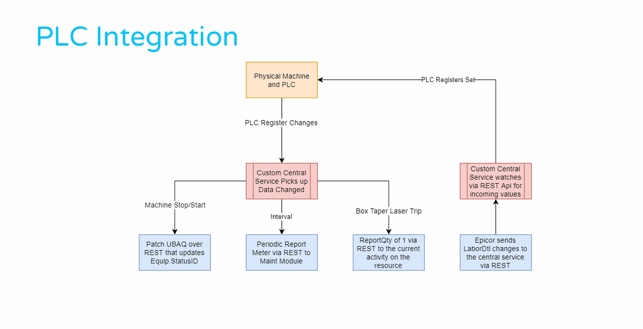

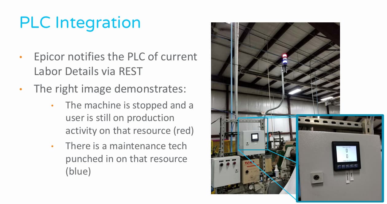

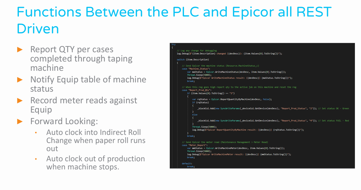

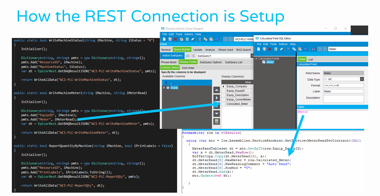

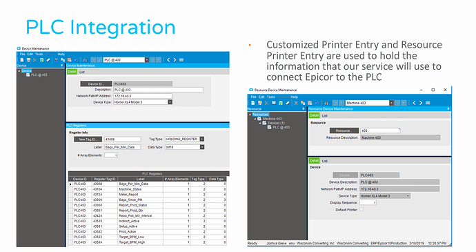

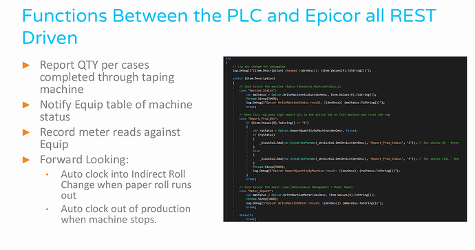

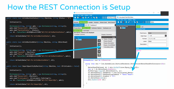

  • PLC of Choice (we use Horner for our application)
  • Inductive Automation SCADA
  • Epicor EFX for the Rest calls from Inductive to sync data to Epicor. In there you do all the data mapping.
  • BPMs that call Rest endpoints in Ignition to sync data to Ignition
A fairly straight forward setup and gets the job done. I did an Insights presentation on it a few years ago. Not sure where the copy of that presentation is at this point but I’m sure @hkeric.wci the horder of all has a copy.
