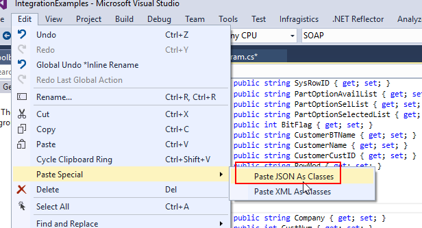

You can generate the class a couple of ways, there are libraries out there that understand OData and will allow you to generate classes from the meta data directly, there are web utilities that will do it too (https://jsonutils.com/). The easiet way to do it is to paste the mata data into a visual studio class using the Paste Special functionality
