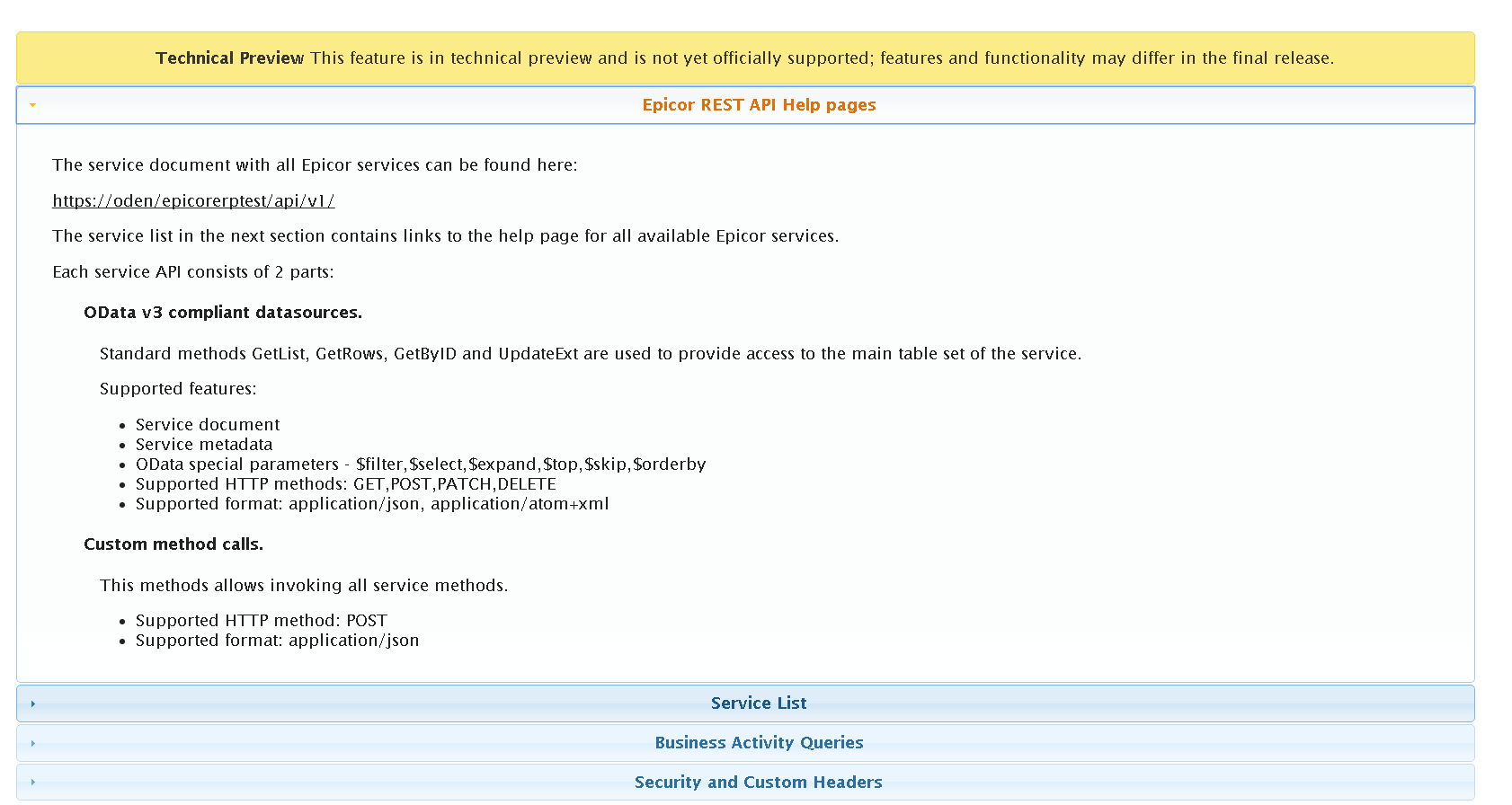

REST does NOT go through the svc files as you attempted above. Look at the REST help to get you to the root ‘Help’ page (myserver/myapp/api/help)

but when i goto epicor/e10rest/api/help
getting response as “site not reachable”

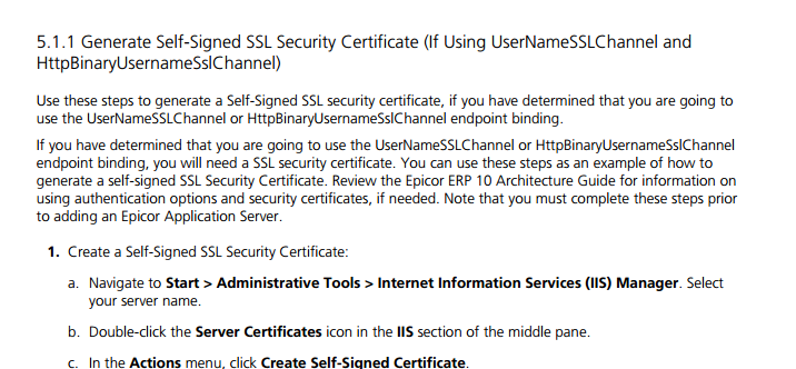

i was following REST Implementation (Technical Preview) section out of the epicor help guide. it did disclose anything about cert. probably, i am using wrong guide. should have used the technical guide from epicweb. anyway, i will create one and keep you posted.
i followed the new install guide 5.1.1 section, and created the cert and binded to the site.

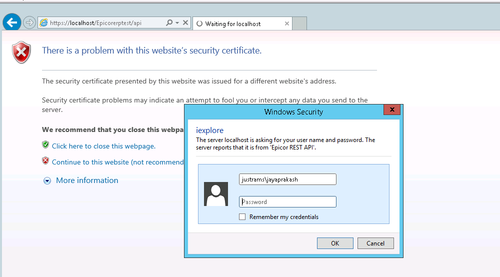

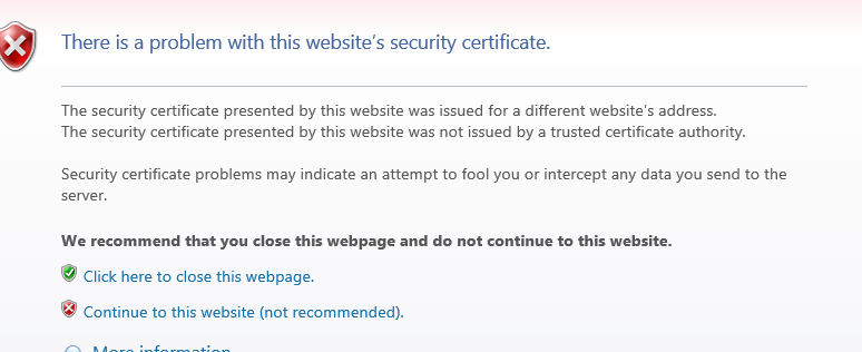

when i navigate to https://localhost/epicorerptest/api
browser throws warning, and prompting for login credential (i am domain admin).
however, even if i enter the credential, it again pops up the same dialog box.
any pointers in handling this issue?
should be your Epicor username/pw ex: manager/manager I believe.
thanks @hkeric.wci and @Bart_Elia … reached the help screen now… i have to run the ie in admin mode. yes, its epicor login credential… game on . excited.

"The underlying connection was closed: Could not establish trust relationship for the SSL/TLS secure channel. —> "
i think its to do with self signed certificate … is there any workaround to suppress this ?? or any guide/reference/limks in solving this issue?
Note: i have already added this site to my trusted zone and the certificate is in my trusted folder.
Search msdn. Export key, import to trusted publishers or something. I’ll find the article when the grandsons are not torturing me…
i have done that @Bart_Elia … imported the certificate and added to my trusted certificate list … still didnt resolve the issue. i will also try to work out something in c#. take it easy and enjoy grandparenthood …
