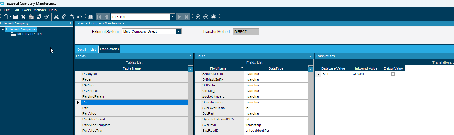

I have setup the below translation on company B however the part’s still error when I update them I have to manually release them from the integrated table workbench by changing UOMClassID to SZT then it disappears

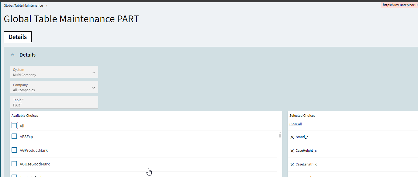

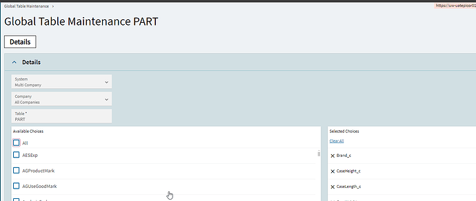

Did you look to see if you have it set to keep in sync in the global table?
That field is not included in our options in the global table to keep resending.

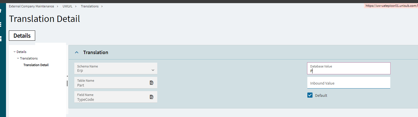

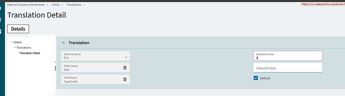

I see in your setup you have a from value, I found in our testing that didn’t make a difference but that would have been on 2022.2. Similarly flagging as default seemed to help make sure that it passed the change through. We do a similar thing with the same two companies where one doesn’t have a part default tax category and the other does.
