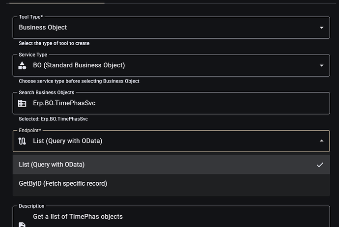

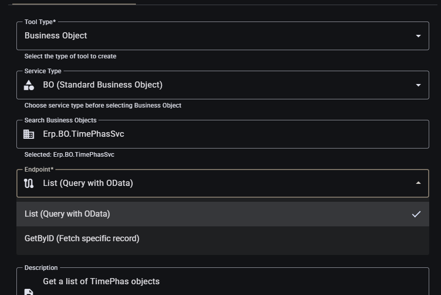

Any chance at supporting other BO endpoints other than GetList and GetByID? For example, I want to use TimePhasSvc to get the time phase for the part. Through tracing, I would need the GoProcessTimePhase endpoint. I suppose I could create a function.
So you can do timephase via a Function as you mentioned (you can use the function skill to make it :wink:)
I purposely did only GetList and GetByID because I want “write” operations to be VERY intentional.
However, I’ll add timephase specifically to the backlog and maybe other read only BOs.

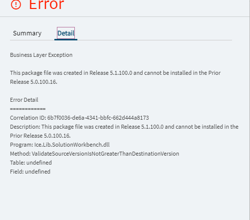

Can someone help me with this? Just trying to install the free executive insights cab solution from the website.
You on version 2023.x you need a compatible CAB. I will send you one.
I am on 2025.1.16
Ah got it, still I will get you a compatible cab the cab we have published right now is for 2025.2. But that’s an easy fix, unfortunatelly EPicor does’nt make it easy to have all these being backwards compatible so I have to make a new one for each major version.
Here you go (I will set it up on the site going forward but since you are the first to ask in this version)
Install this Cab, the rest of the setup should be the same.

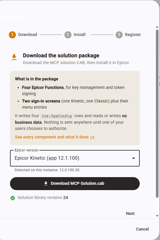

Looking to create the connection and it is missing the UI. Looks like i am unable to download the MCP file either.
Hi Devin,
Not sure i follow, what do you mean its missing the UI?
For your version select 11.3.100 from the DropDown and Download the CAB
Install it,
Then (depending on your permissions) Open up the Library Function called MCP and Make sure its Published / Enabled for your Company
Then just click Next → Register.
okay im good now.
