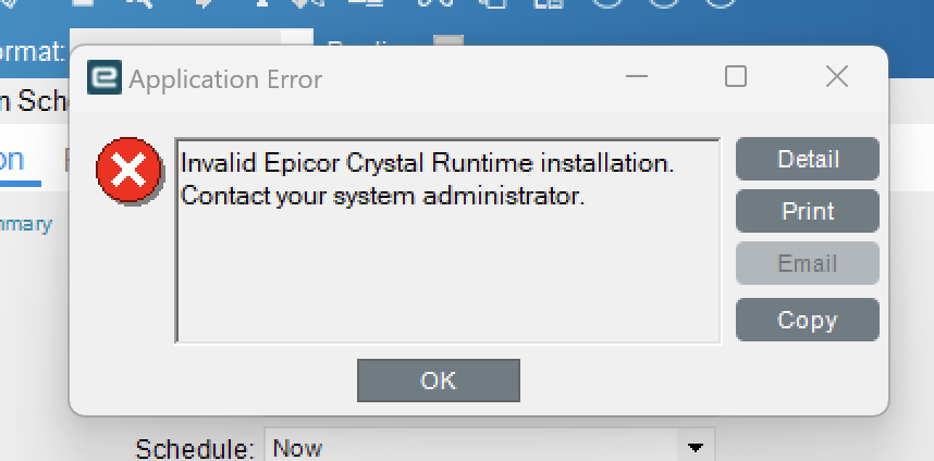

Seeing an error I think is related to the update. I think it’s a similar situation to this post.
Update over the weekend. Crystal reports installed, also reinstalled to make sure. Get the error below.
Basically it’s acting like it’s not install. It’s on the smart clients.
Crystal reports version installed: 13.0.14.1720
Anyone seeing this as well?
it’s on a KB I had the other day, let me see if I can find it.
@carguy , here’s the KB: KB0135448
Thank you that solved it!
