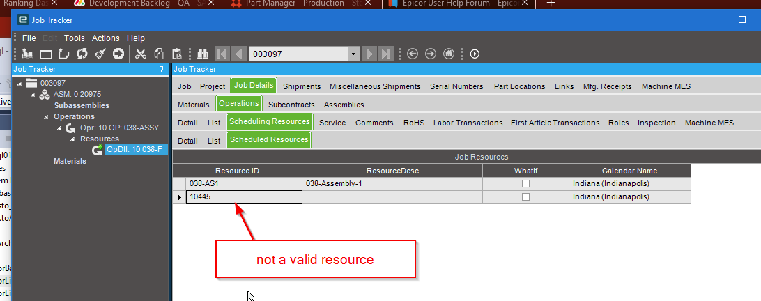

So we ran across a problem yesterday, where someone could start activity on a job, but whenever they went to end activity, they got a null reference error. After copying the database and debugging, we finally found out that we have jobs with scheduled resources that are valid resource IDs.
It looks like these are employee IDs. Is that a thing?
In this screen shot there are 2 resources, but in the problem job it was only the invalid one.
I think we figured it out. We had some employees set as the resources for some of these operations, (which they really shouldn’t be) and someone removed that from their employee record. So I believe that the ones that were removed were the ones that were not finding the proper resources and setting off the exception.
OK, so since that was the error, I found only 10 jobs that needed to be rescheduled.
