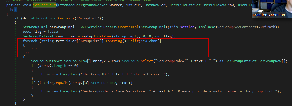

Invalid Sec Group? Says who?

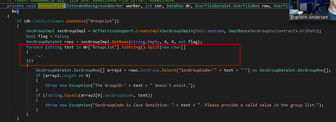

@Banderson and @Mark_Wonsil were correct, indeed it is ~.
I suppose I made the assumption since a BAQ spit out commas, that’s what it expected-but assumptions…
DMT Expects Tildes according to their code
#Assume
I’m surprised any of them worked with commas… (or did only the single ones work???)
I bet the singles and blanks are the ones that worked. Thanks all for your input, what a community.

I love that @Banderson gave you the answer 30 minutes ago and then we spent 30 minutes trying to prove him wrong #WhatATeam
Screw Occam’s razor :joy: we do it the hard way

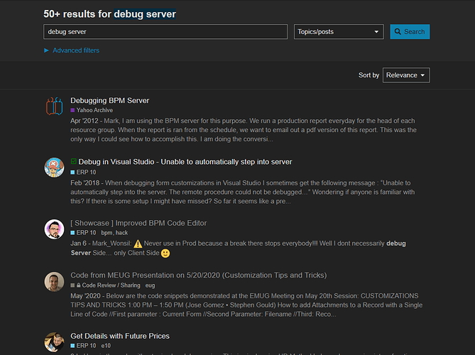

Haso told me to have a dedicated environment of course, I just need to get into this.

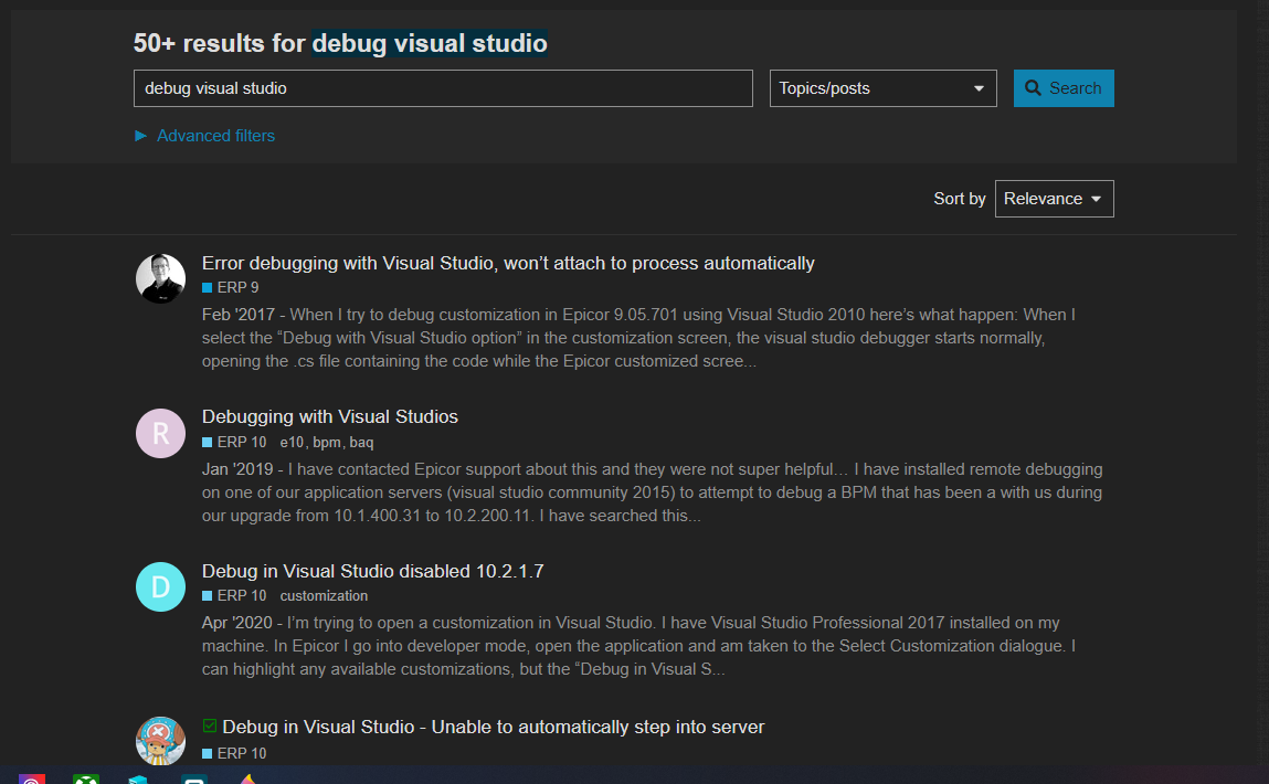

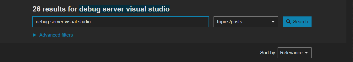

Are there any guides on Epicweb that outline it?
I’d bet money there is not and never will be.
If only there was a place to put that kind of information… :unicorn:
It’s right here in Epiusers… what more do you want? :stuck_out_tongue_winking_eye:
A summary…
He’s talking about server side stepping
