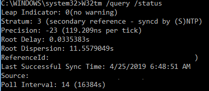

Hello,
The workstation that got error was just syncd by (S)NTP) about 12 minutes prior to that issue happening.
But, why does it still show that the allowed clock skew is ‘00:05:00’ even though we already increased it to ‘00:10:00’ in web.config?
