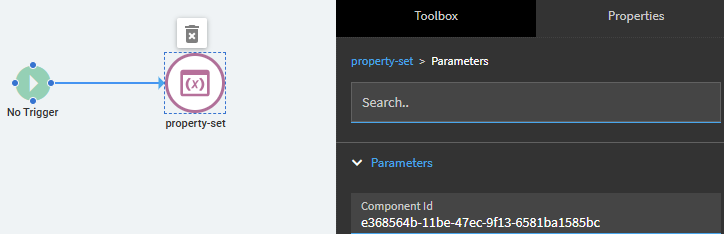

Invalidate action Component ID uses GUID

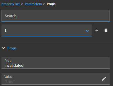

I assume the GUID that is in the Component ID on the property-set widget under Parameter > Props
that sets the invalidated value under
to ‘invalidated’ is likely the GUID for the Grid that is going to be triggered to refresh.
It’s for sure not the Id on the grid -
I suppose it could be the GUID for the DataView but other than picking through the JSON, not sure how to find it.

I have gotten this to work before by filling in the grid id with my own value and referencing that. I can’t remember where I did it so I don’t have a screenshot at this moment. But I remember it worked.
Ahhh. GridModel.Id not panelcardgrid.id :+1:
Yes it was a PITA for me to figure it out but works like a charm once I did.

Sorry, didn’t read to the bottom. Sound’s like we can wire up our own invalidate action and just add the grid Id in the Component Id. Let me know if I am misunderstanding your responses.
geesh. looks like grid id could be lotsa things. :wink: :man_shrugging:
