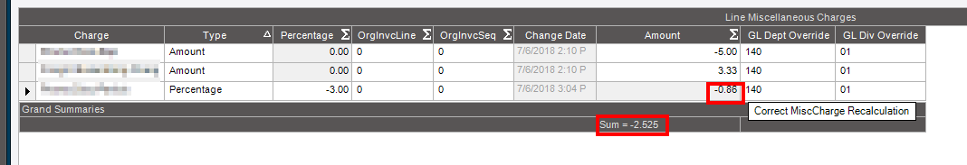

The issue I am running into is when I update the InvcMisc.MiscAmt/ InvcMisc.DocMiscAmt with the new calculation, the InvcDtl.TotalMiscCharge will not recalculate correctly.
Currently I have the Following code in my InvcMisc DataDirective (In-Transition), however, the InvcMisc.MiscAmt will calculate and show on screen correctly, but the Sum of all the Misc Charges on the InvcDtl does not recalculate correctly.

ScreenShot of correct MiscCharges
Screenshot of incorrect InvcDtl Sum of Misc Charges
Any help would be appreciated.
