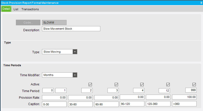

Where can I find details or steps to setup parameters in Stock Provision Report Format Maintenance.
Regards,
Faez

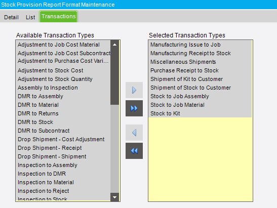

Slow moving stock report will help to get the details. The aging bucket can be defined.
Default report provides below columns.
Slow moving format can be defined from “Stock provision report format maintenance”
This can be opened from mouse right click on the “Slow moving format code” drop down.
This is how we are setting up aging buckets for the Slow Movement Stock. You might want to set up which transactions would be the conditions to identify last used date as well on Transactions tab.
