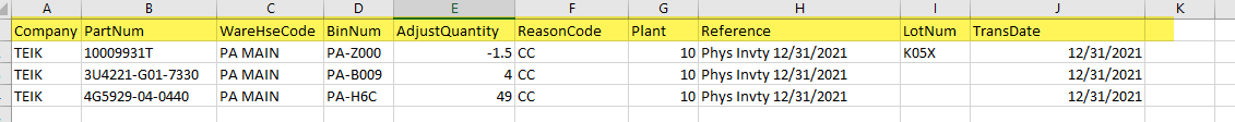

Hi Alan,
We DMT Quantity Adjustment every year for our annual inventory. We also occasionally cycle count and use it for that too. DMT of Quantity Adjustment works great for us. We input a reference note to describe our reason for the mass adjustment. Here’s an example of our template from last year:
Nancy
@Nancy_Hoyt Thank you. That’s what I figured was the best way.

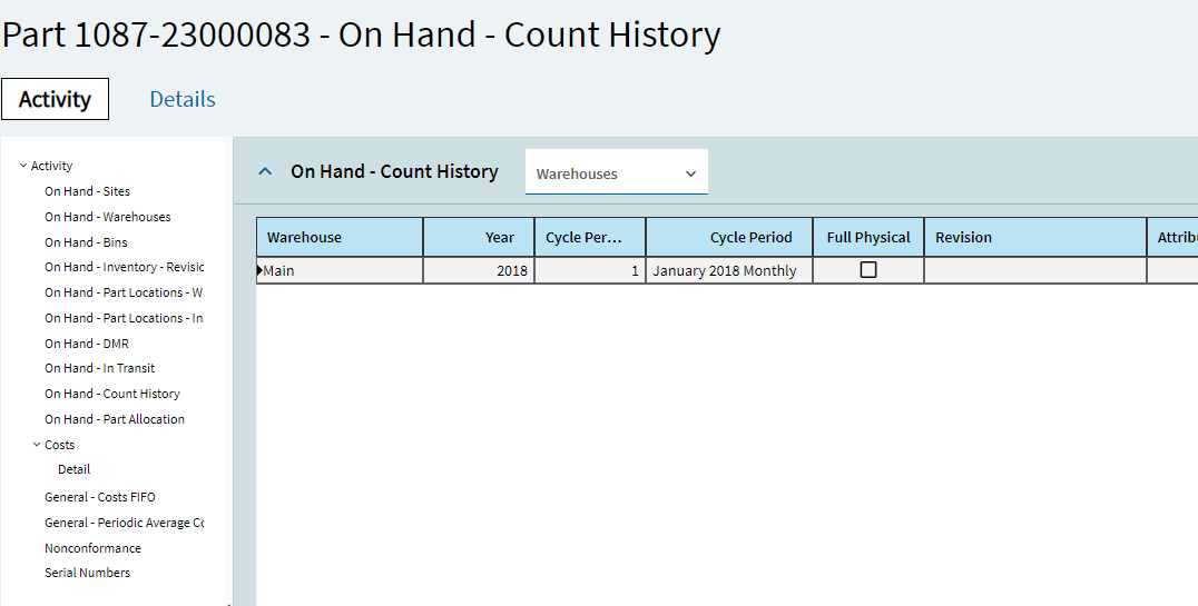

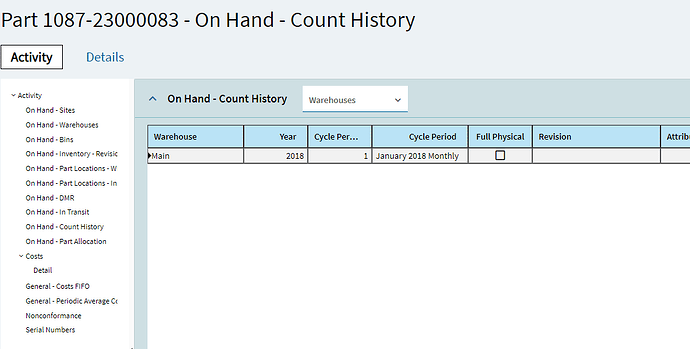

Just going to put in my 2c here. If you do qty adjustments for stock taking you lose the ability to see part stock take information in the tracker… Not to mention all the controls that go around the process. For example the count variance report…
Agreed it’s a bit clunky and printing tags etc feels like duplication of work… You can do a paste update into the count tag list screen.
This is what it looks like in the tracker
I encourage everyone if your not using it to review the process and see where you can potentially streamline. There are ways…
