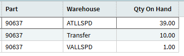

Ok so the actual inventory values according to partwhse are:
The actual demand values are:
The question is those 10 pieces that are being transferred, because none of the tables tell you which plant they are actually in right now.
MRP suggests purchasing 1 for the first site which would make sense if the 10 in the transfer warehouse still belong to the first site. And 39 for the second site, which again, would make sense if the 10 in the transfer warehouse belong to the second site. So its Schrodinger’s inventory, it exists in 2 sites at the same time.
