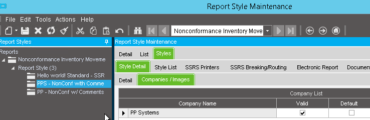

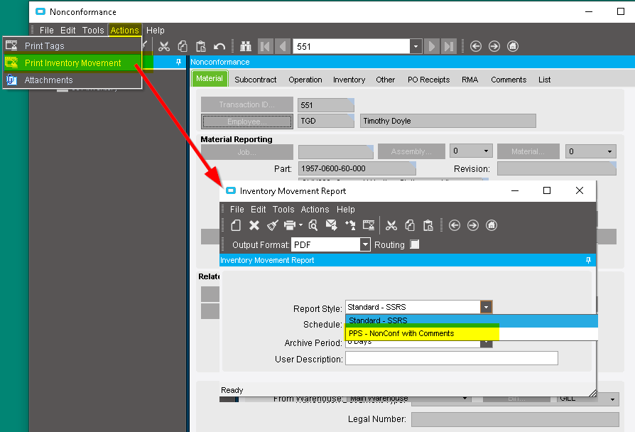

I am Live in 10.2.200, and testing 10.2.700. But I’m stuck - unable to run a custom Inventory Movement Report from the Nonconformance screen.

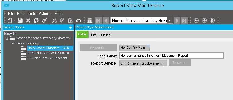

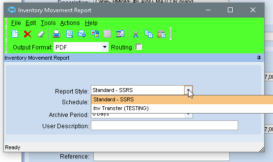

In 10.2.200, the Report Style ID “NonConfInvMvm” can be modified to point to a custom report, that appears as an option in Nonconformance > Action > Print Inventory Movement.

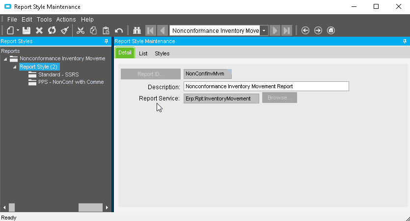

In 10.2.700, the same Report Style “NonConfInvMvm” also includes the custom report, and an edited Standard SSRS description, but the Print Inventory Movement screen does not seem to be using that same Report Style.
Other Report Styles, for ARForm for example, work as expected - custom report style show up on the Report Style drop down for selection when printing the form.
Is there a different Report Style ID I need to use in 10.2.700? If so, how do I find it?
Or is there something unique about the Inventory Movement Report that has changed?

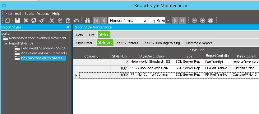

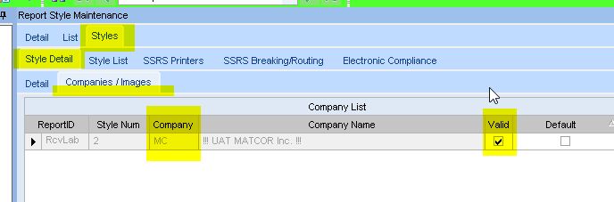

There’s an enabled checkbox on the SSRS Breaking Routing tab that is NOT checked. And I can not check it for these added reports (I have never used Breaking/Routing).
We are a single company, but there is no company checked for any of the Report Styles
I changed the StyleDescription of the Standard SSRS style to see if it would show up in the drop-down box. It did not, so that makes me think I’m working on the wrong Report Style ID.

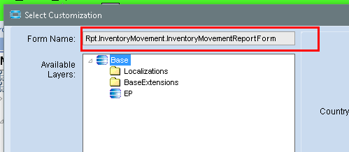

Here’s the Process Calling details for Inventory Movement Report from Nonconformance:

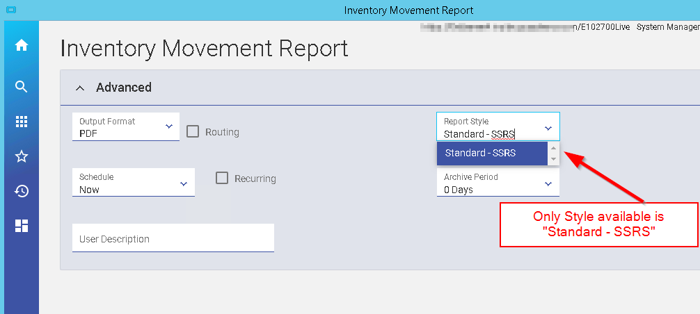

But when I choose OK, a new-fangled Kinetic screen opens without the usual Select Customization choice. I can then choose Customization from that Kinetic form, but that opens with a lot of things that I don’t recognize.
I’ve tried to turn off Kinetic on log in, but this form still opens in Kinetic.

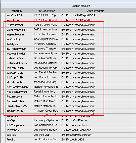

Maybe try making a new style on a report that doesn’t have any custom styles - any from that screenshot of search results should do. I’m thinking that the up lifted styles are broken, and even adding a new style, still doesn’t show.

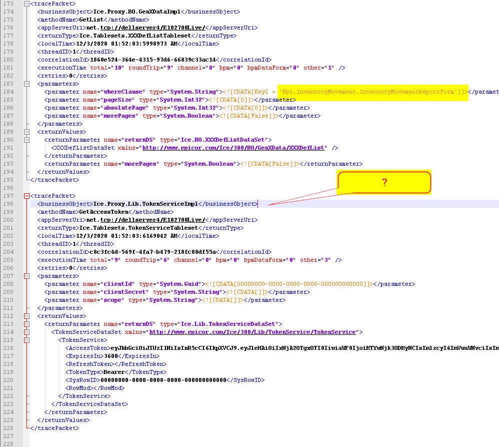

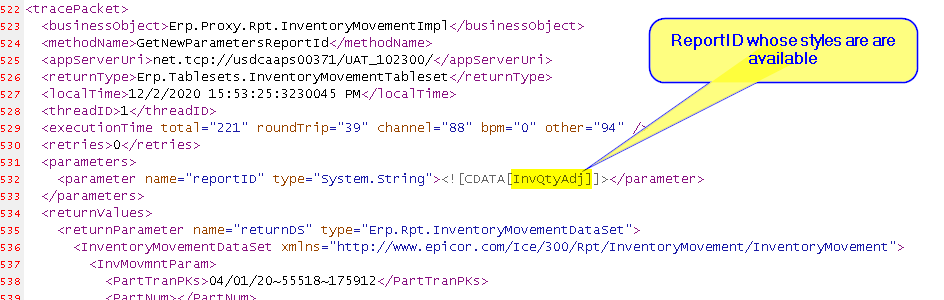

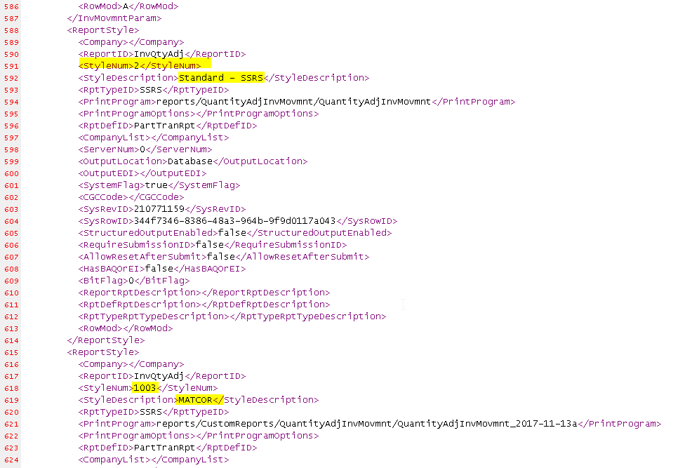

And if you really want to dig deeper, enabling tracing just before selecting the Print function.
When doing that in the Qty Adjustment form, I get:
No it is not. I changed the description from “Standard - SSRS” to “Hello World Standard - SSRS” in the Report Style for ID NonConfInvMvm, but I still get “Standard - SSRS” in the form that opens.
I’ll check out Traces tomorrow, that’s a good idea.
Good question. Yes, when I run the standard style movement report from the Nonconformance screen, it does print the right Nonconformance version of the Movement Report.

I got an answer from Support. There are now two different Report Style IDs for the same Nonconformance>Action>Print Inventory Movement.
If Kinetic is active, Report Style ID = IssMatInvMvm
If Classic is active, Report Style ID = NonConfInvMvmt
After updating from 10.2.200 to 10.2.700, our custom showed up on the Report Style list when Classic was active. But I have to add our custom Report Style to the new Report Style ID IssMatInvMvm for it to show up when Kinetic is active. (Since I’m just starting my Kinetic ‘journey’ it took me a while to figure out that I have to turn off Kinetic in User Preferences, not just at the log-in screen checkbox).
