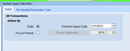

Having Earliest Apply Date (EAD) setup prevents user entry of a date that would create a transaction prior to the date setup.
With EAD setup as:
(there are no type specific entries. So all contexts will use that 12/1/2019 date)
I can do a Qty Adju dated 12/5/2019. But trying to do it with a date of 11/30/19 gives me:
If you do have to correct a mis entered entry, do so before enabling the EAD.

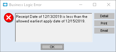

It looks like it even catches transactions that occur without the user entering a date.
For example, We had a PO receipt on 12/13/19, marked as Received. If I set the EAD to 12/15/19, open that receipt and try to uncheck the Received box, I get:
That’s because the marking the receipt as Received, creates PUR-STK transactions with positive qty’s, and a tran date of 12/13/19.
When the receipt was “un-received” (by clearing the Received checkbox), it creates PUR-STK trans with negative qty’s, and a tran date of 12/13/19.
Earliest apply date stops transactions from being posted into prior periods.
