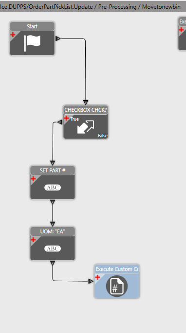

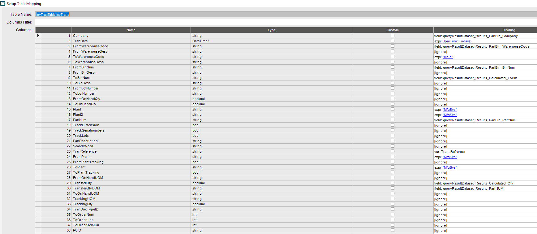

I am having trouble transferring a Part with a specified quantity into a target bin. I can do it manually, but with my code it’s wanting a PCID which was never enabled on our Epicor. Manually transferring doesn’t care for this PCID, but with widgets or custom code it does. How can I get this to go through without involving the PCID?
