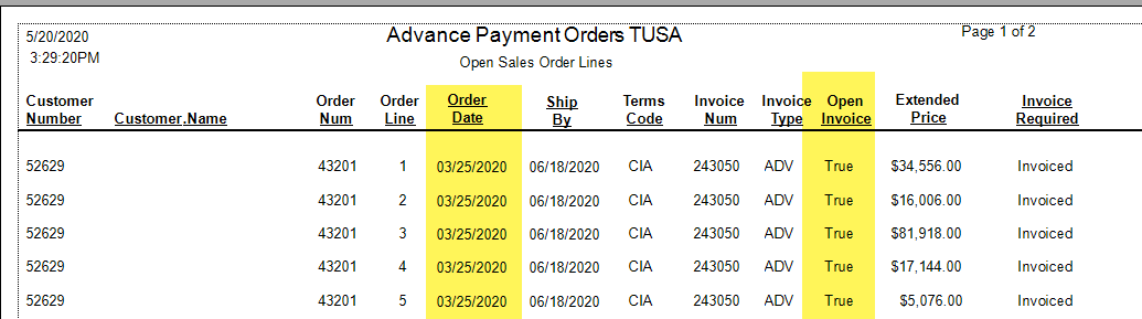

We start with almost all customers on credit hold, per finance preference. If prepay, then an advance billing invoice is done and the credit hold on the customer remains until payment received. For non prepay, a credit review is done as needed, and then we invoice upon shipment. We’ve made a report to be reviewed weekly for the advance payment orders. Here’s an example of a customer with an outstanding balance due before we plan to ship.
Nancy
