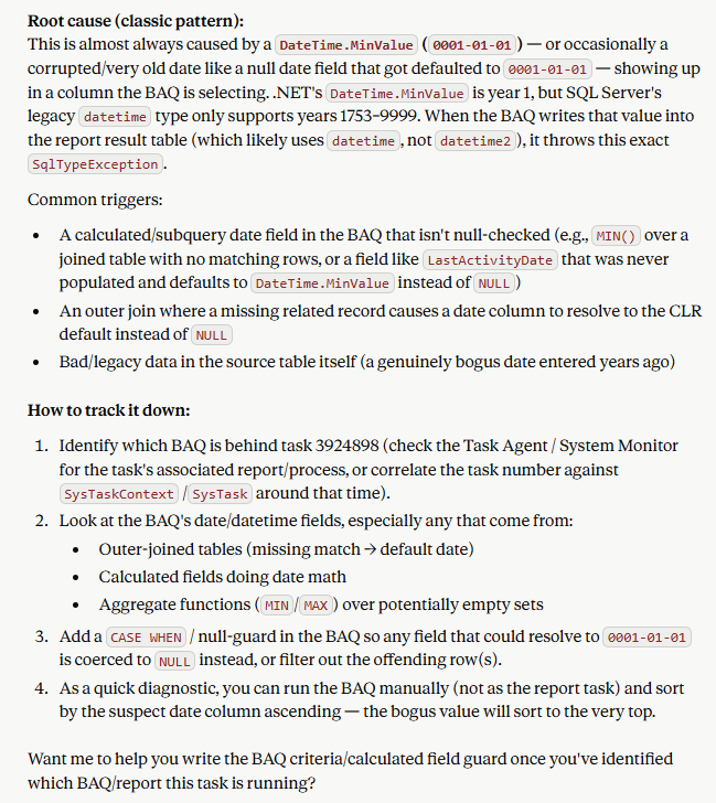

Ran into this with one of our reports too and asked AI to review it (below) and sure enough null date fields are now showing as 01/01/1. Looks like Epicor changed how null dates are displayed.
In my case it was a BAQ report so was able to add a calculated field to overcome it and modify the SSRS report. Total unneeded PITA but :man_shrugging:

AI review:
