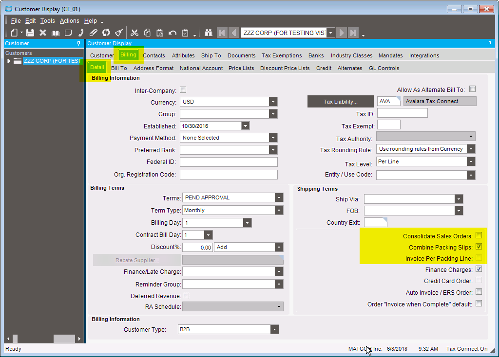

Hi Bryan,
Could you clarify where this settings are in customer entry screen?
Regards
Alek
(from the field help)
  • Consolidate Sales Orders - Select this check box to indicate this customer can have multiple orders placed together on the same AR invoice. This is used during the Get > Shipments command in AR Invoice Entry. If you clear this check box, separate invoices are created for each order placed by this customer.
  • Consolidate Packers - Used during the Get Shipments program within AR Invoice Entry, this option controls how invoices are created if multiple packing slips are generated for this customer. Select this check box to indicate all packing slips created for the same order and fiscal period are billed on a single AR invoice.
    If this check box is clear, each packing slip that is pulled into the AR invoice batch creates a separate invoice. This happens even if they were created for the same order.
  • Invoice Per Packing Line - Select this check box to indicate an invoice should be created per packing slip line. The Get Shipments option in Invoice Entry generates one invoice per each packing slip line for customers with this check box selected.
