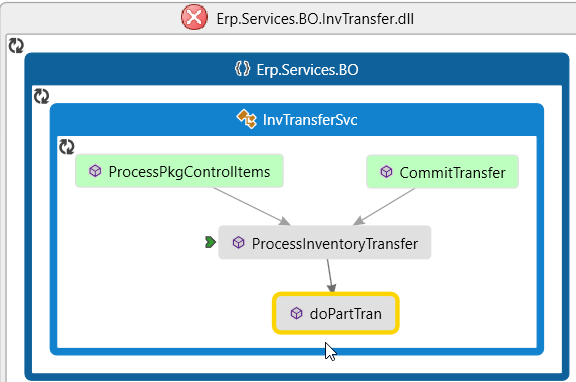

If it helps, here is where the failure seems to occur:
Create_PartTran(ref PartTran, MainDate, MainTime, out PartTranError);

The problem seems to be with:
ExistsPartBinDeferred(Session.CompanyID, Part.PartNum, MainWhse, MainBin, ttInvTrans.TrackingUOM, MainLot, ttInvTrans.PCID)
The system will try up to 10 times to ensure a deferred part bin doesnt exist, pausing 1s between each attempt. After 10 seconds, it kaputs that error. Perhaps a Db.Validate after each commit will solve it?

Sure thing, I enjoy the chase. Although I havent accomplished much yet. It seems the PartBinDeferred is not an exposed table. I can also see it has it’s secret squirrel library with (internal) classes like ProcessDeferredUpdates.
I see that the PerformMaterialMovement potentially calls several methods from the lib, which I assume handles all of the little automagic things Epicor does in the backgrounds when you move\issue parts\lots\etc:
LibDeferredUpdate.PostPBOnHand
LibDeferredUpdate.PostPLOnHand
So, it seems the BO should be handling all of this. My guess is the transaction scope of the BPM is the limiting factor. I would imagine that in your foreach loop of your records to transact, if you had each iteration in a TxScope AND Got a new instance to the IssueBO each time, did the transaction and then completed the transaction scope - it MIGHT work. Let me know, curiosity runs deep.
