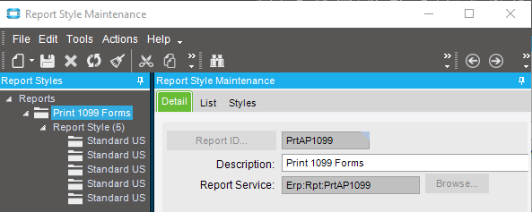

Heather - I am trying to create a custom Report Style for the 1099-Misc using the new file you shared and am not able to see my new custom report style in the drop down list when using “Print 1099 Forms US”. Is there a trick to get a custom report style to show here? I have created other custom report styles for various reports and have never run across this issue.
Thanks,
Debbie
Report ID is 1099 / Report Service is Erp:Rpt:Prcs1099
Hi Debbie,
You need to add your new Report Style to PrtAP1099 in order for it to show up on the “Print 1099 Forms US”. It’s a little wonky the way they named the Report Style for that Form…
THANK YOU!! For some reason my Report was called PrtAP1099CE but once I added my new custom report style to this I was able to see it in the drop down and print.
