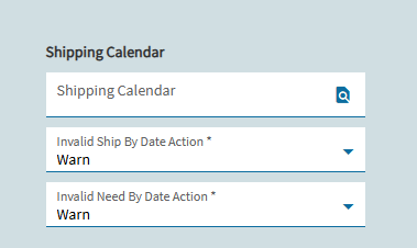

If the version you are showing is the one that you are on, then you should have the newer “Shipping Calendar” setup option in your Site Configuration > Shipping Receiving. Create a separate production calendar (called Ship, or whatever), then set that as your Shipping Calendar.
Then you have the option for None, Warn, or Stop for invalid Ship By and Need By dates on your sales orders. We don’t use this feature, but IIRC user will get a warning/error message if you’ve got this set to Warn/Stop.

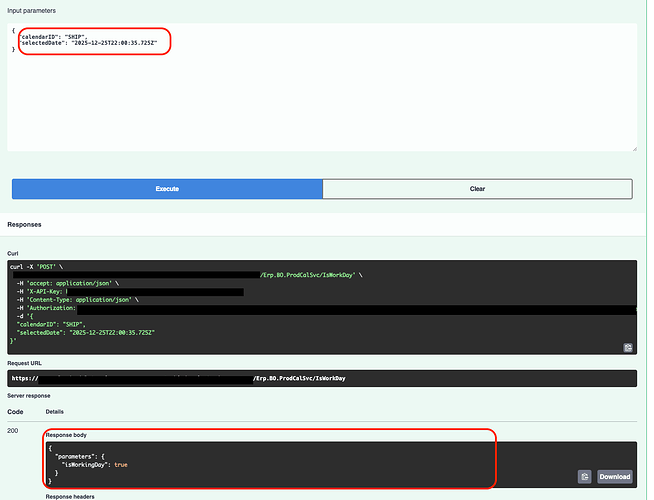

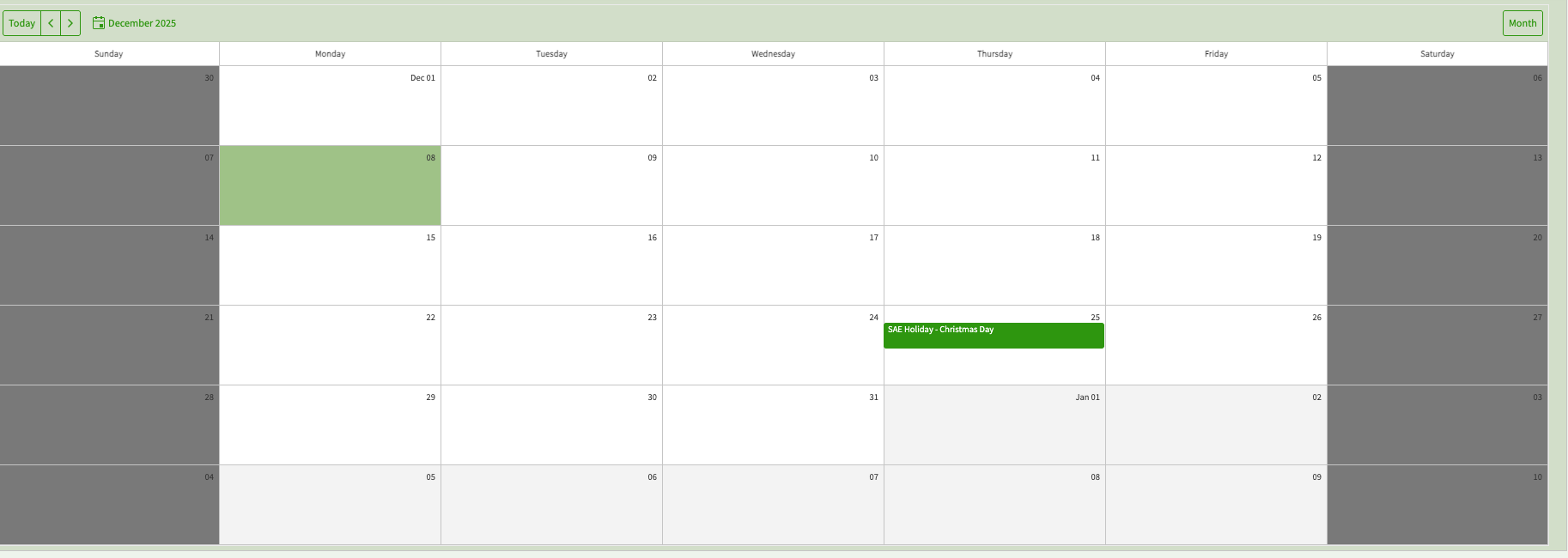

I contend that the issue is with the Erp.BO.ProdCalSvc.IsWorkDay method. If you open this method in Swagger and send in the non-work day you created in Step #2 above, you’ll see that IsWorkDay comes back as true, even though it’s marked as an exception on the calendar.
Shipping Calendar with 12/25 marked as a non-work day
Results of IsWorkDay call

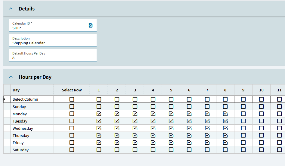

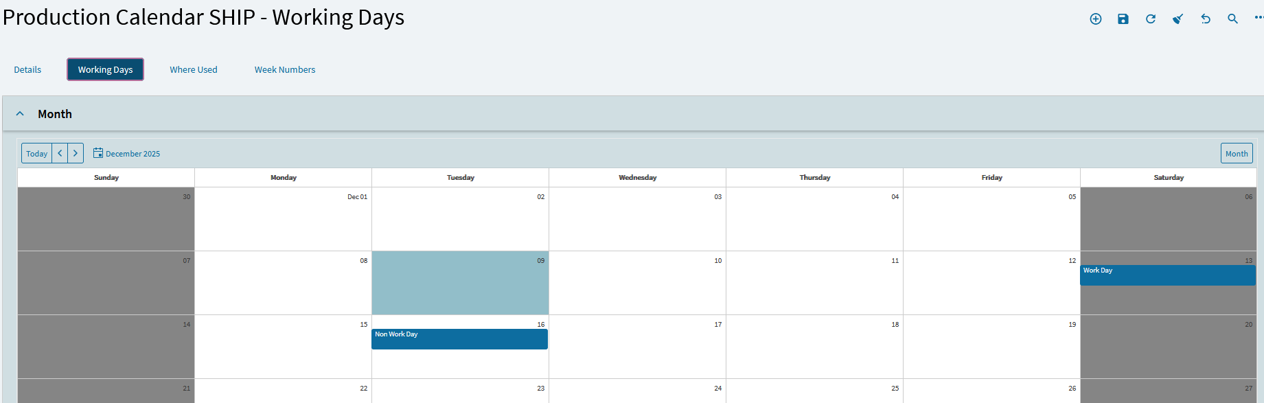

It looks like this may be fixed as of 2025.2.6? Currently testing for an upgrade and I’m seeing the error/warning is taking exceptions into account. For example, given this 8x5 calendar:
With the following exceptions (Saturday overtime and Tuesday closed):

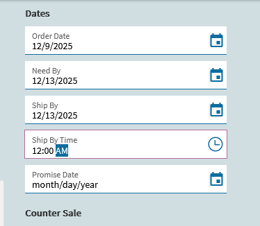

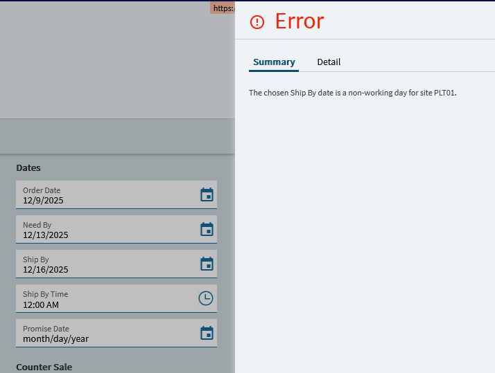

Trying to enter an order with a Ship Date of 12/13 (Saturday) works and is allowed. Entering an order with a Ship Date of 12/16 (Tuesday when closed) does not work, which is what we want.

I’d be interested to know if you test that date you showed on your sales order using the ProdCalSvc.IsWorkDay endpoint in Swagger if it returns false for you?
Sorry Randy, I made an assumption that was incorrect. Sales Orders don’t appear to use the ProdCalSvc.IsWorkDay method.
I’m trying to test this in 2024.2.26. How do you delete a an exception in Kinetic? In classic you could select it and hit the delete key and remove it. That doesn’t work in Kinetic.
It shows false for the 13th (Saturday) and true for the 16th (Tuesday) when it should be the opposite. Looks like that issue is still present in 2025.2.6.

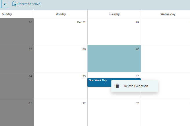

You can right-click the exception and select delete.

I don’t get the right click context menu in 2024.2.26. They must have fixed that somewhere later.
They did. You actually have to unhide a layer in App Studio to be able to see the exception after you create it in previous versions. Or use DMT.
Ah, Ok. Good to know. I just went back to classic to delete them :melting_face:
I think you can double click the exception and then clear out the description, which will then remove it.
I noticed they added a right-click option to delete an exception in the latest version on Pilot as @tsmith pointed out.
