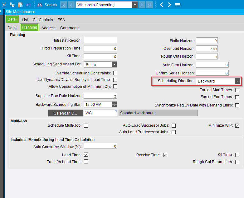

If this is set as backwards (see site maint screenshot), and you are running global with finite, and the specific job is not set to forward and it’s still scheduling forward I would be very surprised. How many jobs are in your test database? I would make sure that when testing you have maybe 5-6 jobs in there and none of them are late. If you schedule them they should end on their Req By Date.

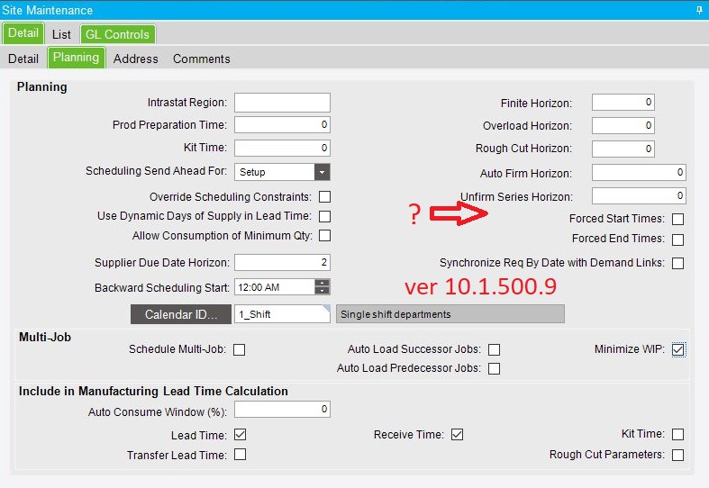

interesting…what version are you running? I do not have that drop down on mine see below:
10.2.200.3 get with the times man! Though since 9 backwards has worked so even without that default option you should be getting backwards scheduling. In a test environment delete all of your jobs except 5 and start troubleshooting with those 5.

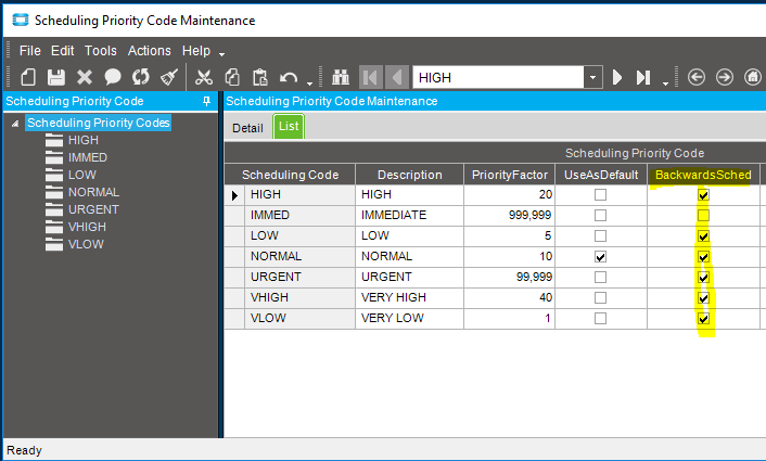

have you checked the selected option on this Adam,
