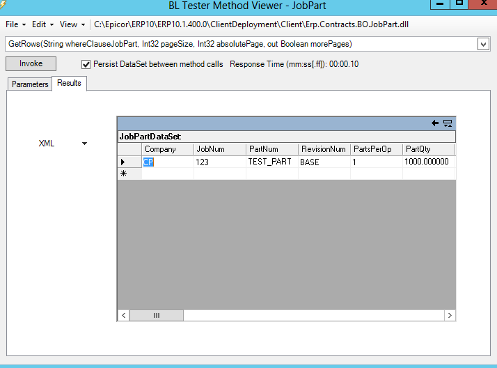

Let’s say hypothetically this works FROM the server itself - then what?
Also assume that from the BLTester - the whereclause works fine
You need to modify this a bit to match what you did but it will return the correct results and you can note the differences

I’m about at this point now! I’m trying for the first time to run the BL Tester from my desktop after copying the BL Tester folder to my system, and I’m getting the same error as above. Anyone have any luck resolving this?
Sorry, I should have clarified that the error I’m getting is the SSPI error. I can run it from the server, just not from my desktop.
