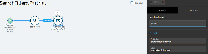

Now I’m trying to just make it a little more “friendly” by adding in a search on Part number in the filter section so that the functional person doesn’t need to type in the part number but can do a search. I’m following all of the instructions (from alearning center course and from other sources) but when I test it out and click on the search icon I get nothing. I’m wondering if this isn’t a possibility???

That would tell me your search-show widget isn’t configured properly. Your screenshot shows the search-value-set, though. Can we see the properties you have set for the search-show?
The search button is used to trigger the subsequent load of the dashboard details below and that works just fine. I’m just trying to add in a std part search so the functional person doesn’t have to type the p/n in each time.
Here’s the info on the search-show.
For troubleshooting purposes, remove the Pre-Load Search Filter stuff and see if it works.
Alternatively, enable debugging, click your search and see if it throws errors in the console or network tab of Dev Tools.
Ah–actually, you know what? Syntax. In your Pre-Load you have Inactive but the field is InActive.

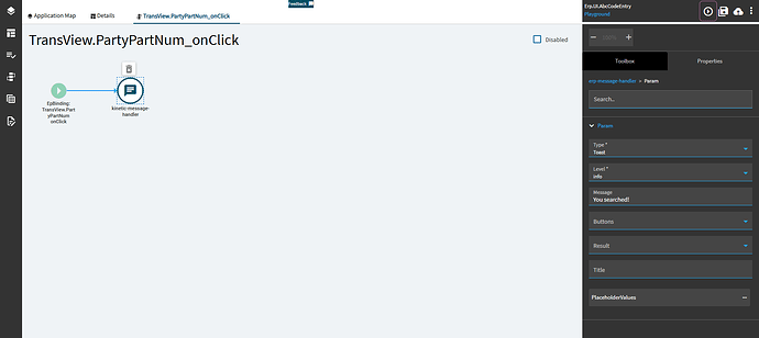

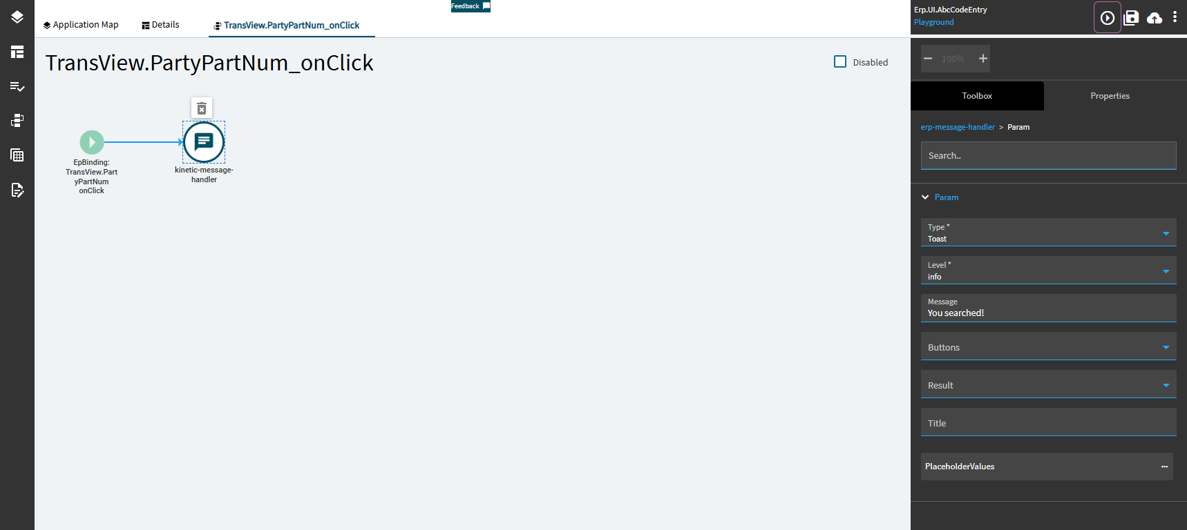

Okay, let’s go waaaay back to the start for troubleshooting. Delete the search-show and search-value-set widgets and replace it with a message-handler widget. When you click the icon, does your message show up?
Nah–this wouldn’t matter. Something is just configured improperly or Kinetic gremlins. Sometimes the very act of deleting a widget and reconfiguring it solves problems.
Nope, nada, no change in functionality (and no message).
That tells me your trigger is incorrect.
Verify the bindings on the both the control and the event trigger.
It looks like the same to me but again, total novice.

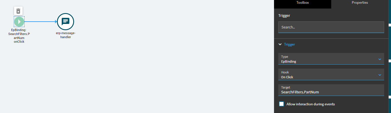

Try this (just trying to get something to fire at this point):
Create a button, within the OnClick event add an event-next and call that event you’ve been working with to see if that message handler fires.
Ok, coming back to this after being diverted to other “stuff”. Well, it looks like I’ve figured out one piece to this puzzle. I screwed up on the SearchFilters event in that I used the hook of “On Click” instead of “On Search”. I corrected that issue and rebuilt my subsequent steps and voila, it worked! It brought back the part number and populated the field … but then looks like it kept going and loaded the entire string of part numbers with tilde delimiter between. I’ve got one last little thing involving operator error which I need to solve but not sure what.
