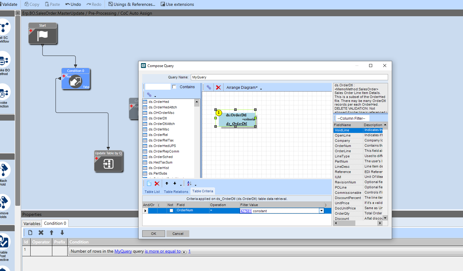

Is it possible to add Customer Table to Erp.BO.SalesOrder.MasterUpdate
What Criteria do you have in Customer in the query above?
I believe it works now.
I’ll test it out. Thank you so much for your help.

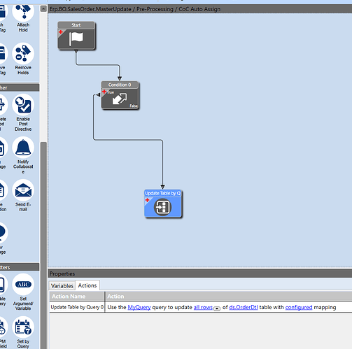

@josecgomez continuation to last question:
if I use this query in BPM, will work on all for lines for this order?
Only on the dirty rows.
is it possible to get all the rows?
I am trying to use Update Table by query, the solution didn’t work as expected.
Also, even if I do a condition check on one row, can I use Update table by query to update all rows in Orderdtl table?
