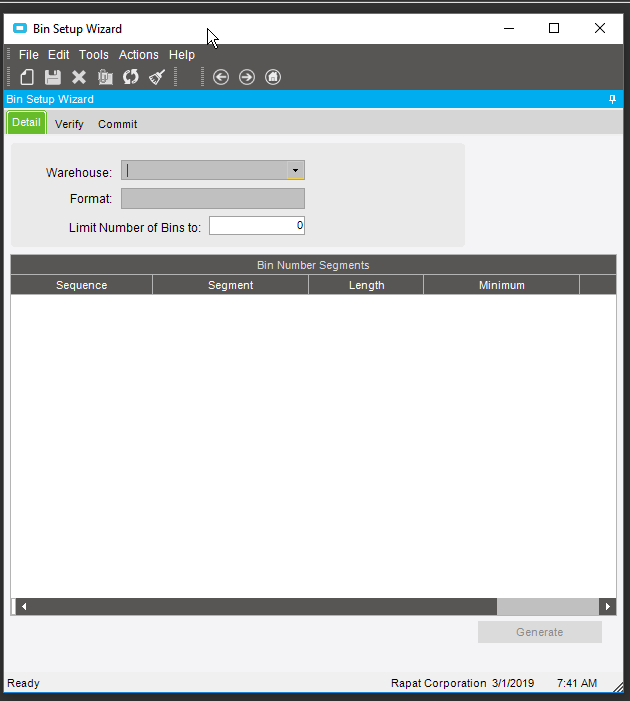

in E-10 there is a Bin Setup wizard that helps you mass create bins. Does that exist in E9? Is that the kind of thing you are looking for?

Secondly - yes there is a bin setup wizard facility in E9.

If they have them set up on order (like it sounds like it does), the E10 version allows you to create a mask type schemes for making the bin numbers. You should be able to put in those factors and make the series of bins that they are asking for.

Can you tell me where you create a mask type scheme and i’ll see if that functionality exists in E9.
Thank you.

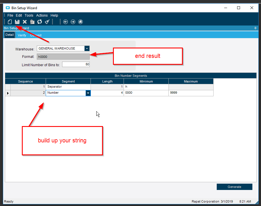

Start hitting new, and it gives you rows. Then you set your segments, divider, number, or letter. Then hit generate.
Then you go to the commit screen and set the rest of the settings and commit them.

Let me know if that feature works that way in E9. I’m curious.
Just tried in TEST, it worked first time.
