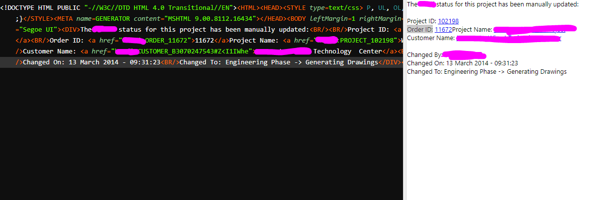

This is the sample of the data and the rendered version. As you can see the data (on the left) is in HTML:
And this would be per row? Like that block is one row?
If so, give me the text version. (redacted of course ).
I can advise from there.
Yes each row has this column, and not every row is like this, but considerable number of rows are like this:
<!DOCTYPE HTML PUBLIC "-//W3C//DTD HTML 4.0 Transitional//EN"><HTML><HEAD><STYLE type=text/css> P, UL, OL, DL, DIR, MENU, PRE { margin: 0 auto;}</STYLE><META name=GENERATOR content="MSHTML 9.00.8112.16434"></HEAD><BODY leftMargin=1 rightMargin=1 topMargin=1><DIV><FONT size=2 face="Segoe UI"><DIV>The XXXX status for this project has been updated for the following reason:<BR/><BR/>Quote # <a href="XXXX:QUOTE_15493">15493</a> has been converted to Order # <a href="XXXX:ORDER_12420">12420</a><BR/><BR/>Project ID: <a href="XXXX:PROJECT_103834">103834</a><BR/>Project Name: <a href="XXXX:PROJECT_103834">Spare Parts For Stock</a><BR/>Customer Name: <a href="XXXX:CUSTOMER_B3090552620%C0T(DCas">ABC Company - Salt Lake City</a><BR/><BR/>Triggered By: Shizar<BR/>Changed On: 14 April 2015 - 16:25:03<BR/>Changed To: Accounting Phase -> Credit Pending</DIV></FONT></DIV></BODY></HTML>
